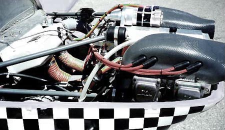

amyvega2005(at)earthlink. Guest
Posted: Sun Apr 20, 2008 7:50 am Post subject: Jab 2200 question |
see attached picture of 2200 Jabiru on XL.
Juan
