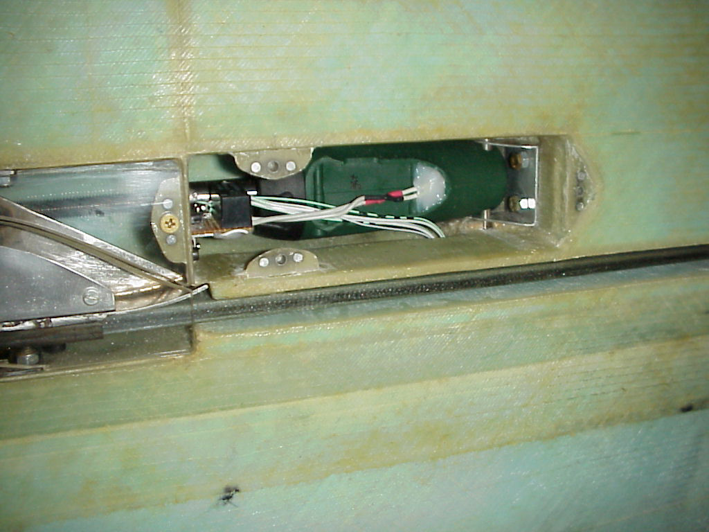

Walter Binder's early Classic mono was outstanding, he retracted the
outriggers electrically into the wing, modified the cowlings and the
windscreen. He claimed he cruised at 140kts with an 80hp 912. He also
towed gliders with it.
Walter is a unique character, wish I knew him but my German is not good
enough.

I only have two piks of the outrigger; this was a German guy near
Hamburg whose name I don't have. It was at least 8 years ago. Jens
Gralfs <Jens.Gralfs(at)airbus.dasa.de> might know. Failing him Harald
linke <0406055601-0001(at)T-Online.de>
Graham
