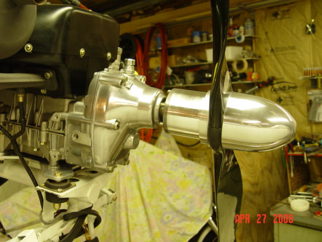

I had some shaking/vibrating ( wings off ) when I started my plane
last weekend...
I'm running two blades on my IVO...Last year it seemed to run
just fine...
Didn't like the shaking/vibration , so I ordered the Balance Master
for Props....( Mercury inside )
Anybody using it..... Like it...?
I asked them if I'm not satisfied will they take it back...
They said 100 day money back ....
Gotta Fly...
Mike & "Jaz" in MN

Mike, I installed one of those gadgets last year to help reduce the
vibes on my plane.
I figured it wouldn't harm anything. It did reduce symptoms some.
Mine are in the category
of what John Hauck calls rum rum, low freq, in and out resonance.
No doubt you will get (good) advice to do another prop balance, as
should I.
If you turn the device in rotation you can hear what sounds like
pellets moving inside.
Sure doesn't sound like mercury but I could be wrong.
Anyone else with experience or knowledge with this?
BB

planecrazzzy wrote: | I had some shaking/vibrating ( wings off ) when I started my plane
last weekend...
just fine...
Doubt the balance master would help much, never heard of a case where it did help very much.
A much cheaper option is to make sure the blades have the same pitch. This is the trick to a smooth IVO in 2-blades - with the hub bolts at full tightness, the torque rods can be slightly "clamped" and won't move on their own when you're in the region of natural pitch.
You can see this by, say, cranking the pitch adjust in a turn or two from natural pitch and then back it out. You'll likely notice the screw unscrews very easily, which means the cams are stationary while the screw moves through the "play" between the cam and its big groove.
If that's happening, make sure when you're doing the pitch adjust to start, say, overly coarse and only rotate the bolt in the fine direction until the right pitch is achieved. DON"T back it out at that point, lock it down right there.
I ran the IVO in 2 blades for years on my trike with very smooth results as long as I made sure of the above...... in 2-blades it's superb on a fast plane.....
LS

You're quite right that I only have 2nd hand info, so indeed my opinion isn't authoritative on it by any means.
Yes, the 582 has a balancing device on the flywheel similar to the balance master, but you have to remember that's a much higher rpm situation and the imbalances it's used for are generally smaller than a prop spinning at 2500 rpm.
I do, however, have years of 1st hand experience with the IVO running in 2-blades and, in that experience, I havn't found a relatively expensive solution like the balance master thingy to be necessary for smooth operation. Again, the typical problem with the IVO is mismatched pitch on the blades rather than imbalance. IVO does pretty good getting their props balanced out of the box (tho occasionally they mess up).
The pitch adjustment, however, ain't so grand with the play in the pitch adjust screw and the tendency for the torque rods to sieze slightly in their holes when the hub is tightened down to spec.
So... I'm merely suggesting that before you go out and spend a bunch of money on a balancer, set up the prop correctly FIRST - it's a zero-dollar solution anyway so it's the most sensible place to start.
THEN check the balance THEN try the more expensive solutions.....
Just my experience, worth what you paid for it,
LS

At 11:15 AM 5/1/2008, lucien wrote:
Quote: | Yes, the 582 has a balancing device on the flywheel similar to the balance
2500 rpm.
Is the 582's device a radial balancer, or just a harmonic balancer that
damps out the torsional pulses? I would think the latter, protecting the
gearbox.
Quote: | So... I'm merely suggesting that before you go out and spend a bunch of
Agreed. No point in band-aiding a problem that can be properly fixed.
It should also be remembered that a balancer like the balancemaster can
only help with radial weight imbalance, which causes motion in the plane of
the propeller. If your blade pitch is mismatched, that creates an angular
vibration or shaft wobble that a radial balancer can do nothing about.
-Dana

planecrazzzy Guest
Posted: Thu May 01, 2008 3:43 pm Post subject: Re: Balance Master ( Prop Balancer) |
I think the fact the Wings were off got overlooked too quickly...
I'll bet if I put the wings on & started it , it would be normal....
Whatever ... The balancer "will" help...
Gotta Fly...
Mike & "Jaz" in MN
