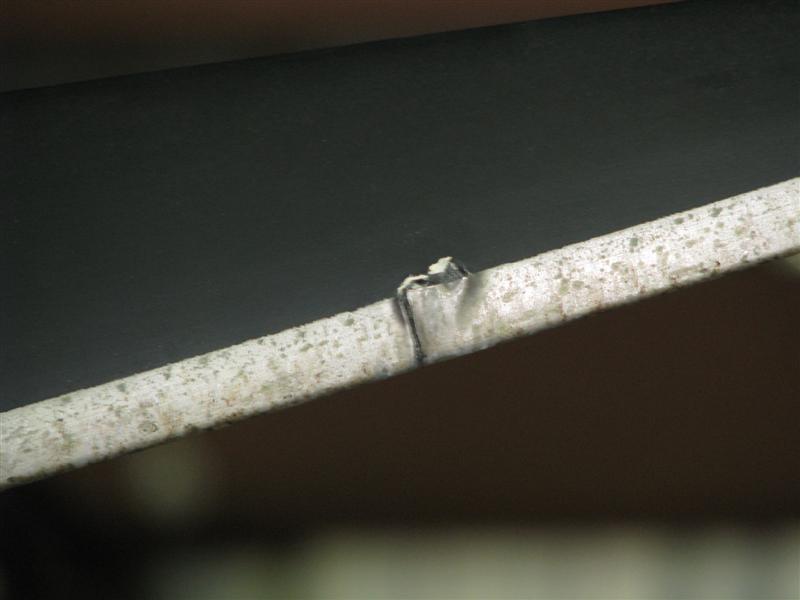

Just wanted to post a note on the repair of my Warp Drive prop. Many of you know I suffered a prop strike when an aluminum fabric inspection plate came off and struck the prop on edge. Never really knew it happened until I was putting the plane back in the hangar.
I flew with an IVO the first 200 hours. I'm pretty sure this prop strike would have took a chunk out of the IVO.
I was almost positive that I would have to replace the blade. I was thinking somewhere in the neighborhood of $300. Called Daryl at Warp Drive, Inc and sent him a picture. He said a repair would be no problem.
Sent him all three blades. Asked him to repair the damaged blade and trim 1" off all three for noise. Went from 72" to 70". He did all that, cleaned and rebalanced the blades. He even got the south Louisiana bug guts off that I couldn't. I can't tell which blade was repaired. All three look brand new.
I basically got a new set of blades for under $120, including return shipping. Certified GA couldn't even get an A&P to look at it for that! He also included some extra 8mm nyloc nuts in that.
I'm super pleased. One thing to note is that there are distrubutors for Warp props. As best I can tell, they just sell and don't do repairs. If you are buying or servicing, I would recommend you go straight to the source.

Now it is time to set pitch and check cruise RPM. You guys have a blast at MV. The wind is howling out there right now. Be safe.
