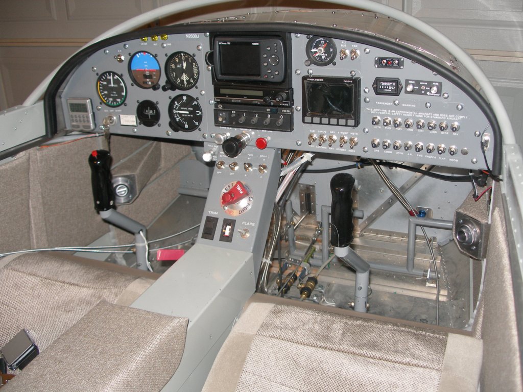

I am building the Center Console and side fairings 6-K-2 no 3 is the side fairing at 200 wide and 480 high. In the new Illustrated parts guide page 6-XN-24 Duel stick option it shows a new longer side fairing going up and over the foot channel as well as new parts 6K2-4.
Has there been a change I missed, or is this longer side fairing part of the duel stick plans?? I was going to build a longer side fairing anyway to cover the rudder cables.
So has anyone got a copy of the extended side fairings? what are the extra dimensions length and hight ect??

I chose the dual sticks option for my XL. During a lull in building, I constructed the center console as shown on the original drawings. It has the full side panels that fasten to the floor. When I got my dual sticks kit, I discovered that the side panels would interfere with the rods that go from the sticks to the horn on the torque tube; plus it would make installation of the fuel selector valve and hoses very difficult. I designed and fabbed an new one from .032 6061-T6 (see photo). It has the sides turned down about 2". I may install larger side panels to hide some of the "stuff" underneath; but that is a project for much later. If you need dimensions, let me know.
Jay in Dallas CH 601XL N2630J "lil Bruiser"

I was planning to just extend it as per the parts drawing , but if anyone has the measurements or actual plans drawing it would sure make life easier.

I have attached two pdfs that can be put together to form a full size pattern of what I built. For scaling, the "match line" must be exactly 10" long. Let me know if you have questions.
Jay in Dallas
