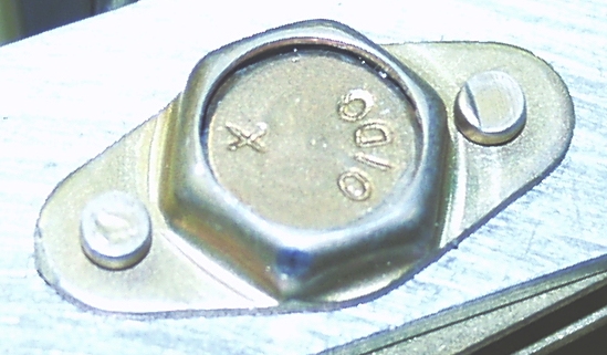

What is this piece of AN hardware? It is holding an AN3 fiction bolt
head in place on the back of the Van's throttle quadrants.
Thanks!

Matt, when you get the answer to this question, please pass it along.
Dale

Matt,
I believe that is a 2 lug hex head retainer (think reverse nut plate). Check out this link:
http://www.spstech.com/aero/fastenerfinder/browse.jsp?category=PLATENUTS
