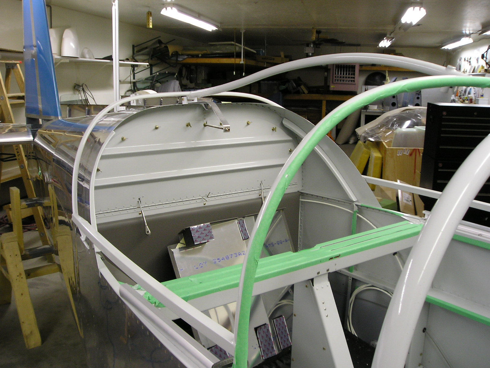

I don't really have any great tips. Mine didn't turn out perfect. I will
agree that the instructions are lacking here. I assume that the tooling
holes are for trimming to. I trimmed a little off both ends, to
approximately where the tooling holes are because I've never seen tooling
holes in the finished product. Then I just used the portion of the
stiffener that fit the curves the best. I ended up with them being a little
shorter than some. Mine come about 3/16" short of the longeron and don't hit
the very last hole at the upper rear side. I don't think it matters though.
I seem to recall some RV6s don't even have them installed at all.
One picture of mine is all I can find right now, included.
Bevan
