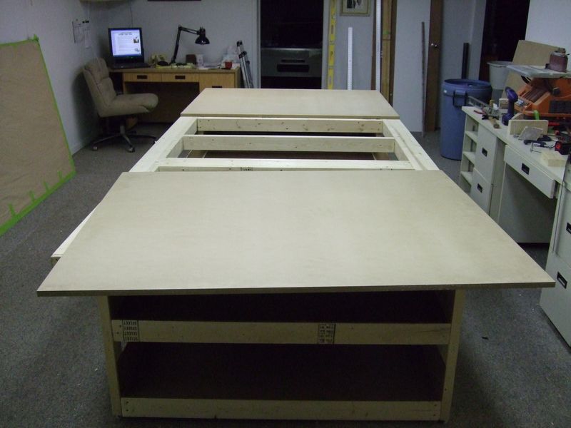

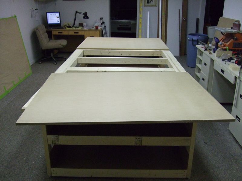

PostPosted: Fri May 23, 2008 5:21 pm    Post subject: Re: Use of 7075-T-6 for wing attach fittings? Reply with quote
Carlos,
You might want to make that four, since I too am building in the basement. The reason is because it's cool in the Summer, and warm during the cold Canadian Winters.
I can get everything out, except for the fuselage, which will be disassembled, and rebuilt in the garage.
Bob the 701 scratch
Three Rivers ,
Quebec
 Filesize:  65.32 KB
 Viewed:  1096 Time(s)
Long wing + vga's, = lo & slo
