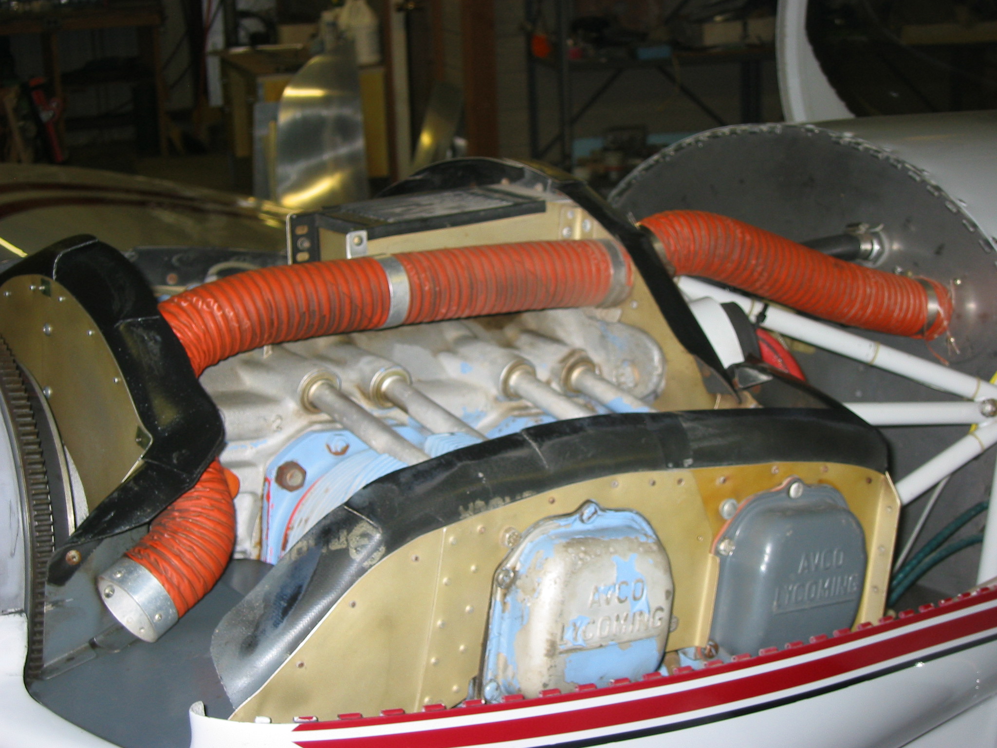

Jim, I tried air off the back of the engine plenum on my RV-4,,,, Too warm. I would recomend a NACA vent. and thick insulation on firewall and under your feet.

I had a similar set up on my rv-4. The air was taken off the rear baffle and run into the cockpit. It was ok until it got hot in the summertime. It was really bad when I slowed down in the pattern.I changed the set up and extended the tube forward across the top of the crankcase to the left opening in the front of the cowl. That was much better. I now measure only a 3-4 degree increase in temperature compared to the rear vent outlet which comes from under the wing. I terminated the scat tube with an aluminum end to dress it up visually up front. With a 540 engine instead of a 320 the heat picked up may be more especially due to the longer length. I plan to do the same on my rocket if I ever can finish it.... I can get pictures if you need them.

I think your plan may be the easiest to try first. If pics are not to difficult, please send me a few. In particular, I would like to see the scoop or forward end of the scat tube and how it sits in the intake.

Here is a picture that I have readily available. I'm not sure how to send to the list, so if the picture doesn't come through, send me your e-mail address and I can send it directly to you. If you need more detail, I can take more pictures this weekend.

I got the pic, thanks Ivan.
