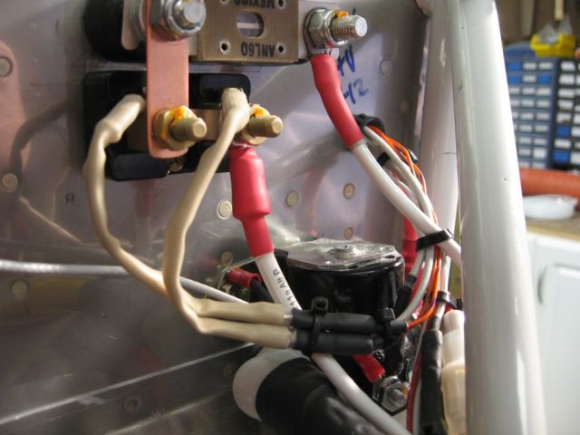

Guys,
for those who are using the sensor pack from AFS where did you place the shunt and the manifold sensor. Pictures appreciated.
Best Regards

Michael,
I mounted the shunt on the left firewall just inboard from the starter
contactor and the manifold sensor on the right firewall, on the inside, near
where the MP line comes through.
