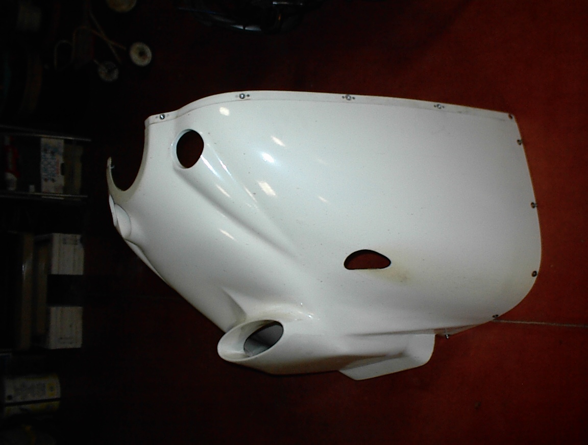

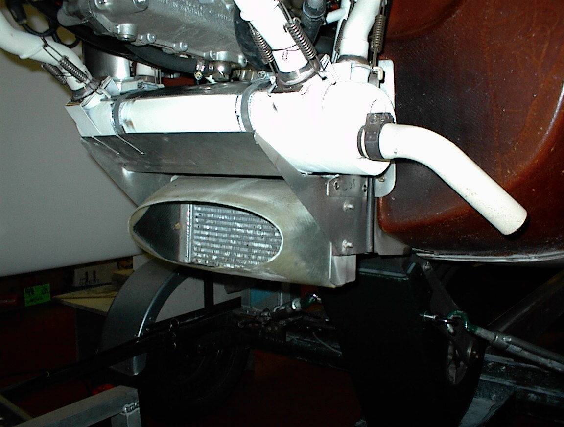

Posted: Thu Jul 03, 2008 1:37 pm Post subject: A question on composits |
Jeff,
In attachment my concept of cowling and inner radiator duct.
Best regards,
Karel Vranken

paul.the.aviator(at)gmail Guest
Posted: Thu Jul 03, 2008 2:47 pm Post subject: A question on composits |
Hi Karel,
Nice looking modification. Do you have the radiators directly behind
each other or to you have the rear one dropped down by 40 mm ?
Paul

karelvranken(at)hotmail.c Guest
Posted: Thu Jul 03, 2008 3:36 pm Post subject: A question on composits |
Paul,
I didn't use the original cubic radiator for the coolant. The surface is
greater and only 1,5" thick with the same contents. I didn't need to lower
the oil radiator. Using the Evans coolant I notice normally in cruise 100°C
for oil and 110°C for coolant. In hot summer like last year in Italy by 41°C
on the tarmac the temperatures rose with 10°C. Oil is changed every 50 hours
and I use actually Shell Advance 4. Next I will change to the Aeroshell
Sport plus. I always use Mogas 98 without alcohol.
Best regards,
Karel Vranken, F-PKRL 912 ULS Airmaster CSU.
