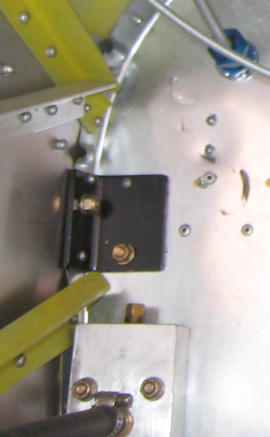

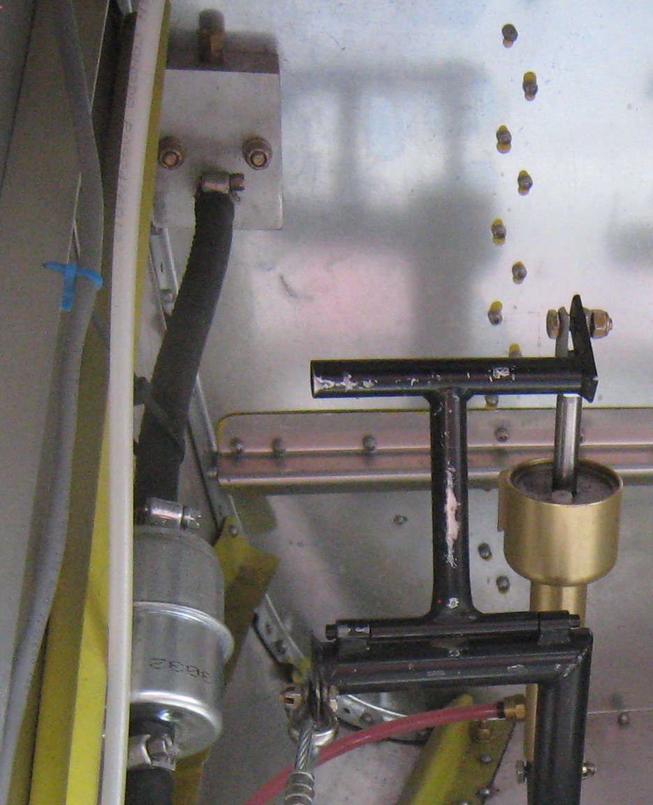

I was looking at Quality Sport Planes’ 701 at Arlington yesterday. They have a large metal block on the cabin-side of the firewall (say 2 by 3 by ½ inches?). Doug Dugger says this is where their return line runs to. I’ve attached a pair of bad pictures I shot. Unfortunately I only could photograph the cabin side. I think the plug at the top caps a hole that was drilled down into the block to form the passage where the two lines on the firewall side join with the fitting from the tanks.
I don’t know who supplied this block. Did it come with the new (ring mount) Zenith FWF? Doug said the block (or something like it) was available from Spruce.
