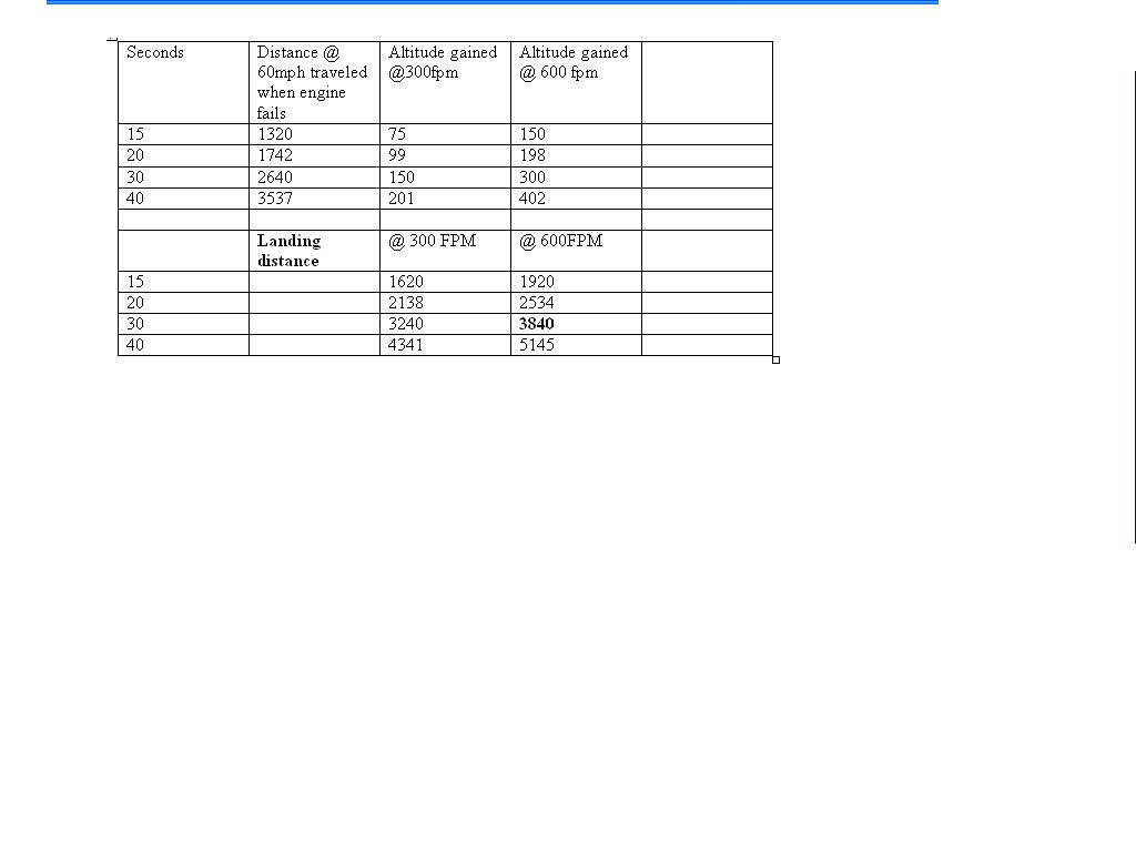

Posted: Fri Jul 18, 2008 5:30 am Post subject: Re: Generac engine test data on my FS II |
Here is my argument that having more engine power will not necessarily save you.
Say we have 2 Kolb firestars one with a 503 and one with the Generac.
Plane 1 with rotax climbs at 600 feet per min
Plane 2 with Generac climbs at 300 feet per min.
Flight conditions:
Runway is 3600 feet long with 80 foot trees 150 off the end.
Ground/ climb speed is 60mph
Glide ratio is 4:1
Engine quits 15, 20, 30 and 40 seconds after takeoff.
At 30 seconds the 503 would put you in the trees and the less powerful engine would allow you to land on the runway.
See the attached chart.
I really over analyze things sometimes

jbhart(at)onlyinternet.ne Guest
Posted: Fri Jul 18, 2008 6:55 am Post subject: Generac engine test data on my FS II |
Grant,
At 30 seconds the 503, by your data, would be at 300 feet agl. At this height, it may be possible to do a 180 and get back to the runway. ???
Jack B. Hart FF004

JetPilot
Joined: 10 Jan 2006 Posts: 1246
Posted: Fri Jul 18, 2008 8:48 am Post subject: Re: Generac engine test data on my FS II |
grantr wrote: | Quote: | The very poor climb rate with the Genrac engine leaves you very vulnerable on takeoff, if you lose the engine on takeoff you will find yourself much lower, and with less landing options than you would with the 503 or with the HKS.
Not true. Either engine could stop at the same altitude. Climb rate just changes the time it takes to get to a certain altitude. An engine out at 300 feet is an engine out at 300 feet.  |
You are wrong about this Grant R,
With a good climb rate, if your engine quits over the end of the runway you are much higher than you would be with less climb. Lets say your engine quits at the end of the runway, would you rather be 200 feet high, or 600 feet high ? That extra altitude would make all the difference in the world in landing options and safety.
To make matters even worse with a low climb rate, you are totally Dependant on your engine running for a much longer time to achieve a safe altitude if your engine quits. Lets say you want at least 500 feet AGL to have a chance at being able to make it to a good place for an engine out landing. With good climb performance, you may only need your engine to run perfectly for 30 seconds to be at 500 feet and have good landing options. With poor performance, you are totally Dependant on the engine running for over a minute to get to the same altitude. Getting to altitude quickly is much safer.
Lastly on power, having lots power to get out of trouble quickly is a proven safety advantage. There are a million unexpected things that can happen in aviation where having lots of power can save you. No one ever plans needing lots power to save their butts, but schit happens.
Mike

grantr
Joined: 12 Sep 2007 Posts: 217
Posted: Fri Jul 18, 2008 10:57 am Post subject: Re: Generac engine test data on my FS II |
Quote: | At 30 seconds the 503, by your data, would be at 300 feet agl. At this height, it may be possible to do a 180 and get back to the runway. ???
That seems too low to do a 180 by the time you get setup for an approach.
Quote: | With a good climb rate, if your engine quits over the end of the runway you are much higher than you would be with less climb. Lets say your engine quits at the end of the runway, would you rather be 200 feet high, or 600 feet high ? That extra altitude would make all the difference in the world in landing options and safety. |
I do not disagree with this. However as I pointed out in my post at a certain point more power could put you in the trees where less power could have allowed a landing on the remaining runway.
| - The Matronics Kolb-List Email Forum - | | Use the List Feature Navigator to browse the many List utilities available such as the Email Subscriptions page, Archive Search & Download, 7-Day Browse, Chat, FAQ, Photoshare, and much more:

grantr
Posted: Fri Jul 18, 2008 10:59 am Post subject: Re: Generac engine test data on my FS II |
Quote: | With good climb performance, you may only need your engine to run perfectly for 30 seconds to be at 500 feet and have good landing options. With poor performance, you are totally Dependant on the engine running for over a minute to get to the same altitude. Getting to altitude quickly is much safer. |
True unless you are doing a steep rocketship climb out and the engine quits at low altitude and a high nose up attitude. That could lead to a deep stall and possibly a lawn dart. As you know a very steep climb out at low altitude can result in a deep stall and a unrecoverable dive into the ground if the engine fails at the right time.

lcottrell
Joined: 29 May 2006 Posts: 1494 Location: Jordan Valley, Or
Posted: Fri Jul 18, 2008 12:48 pm Post subject: Generac engine test data on my FS II |
Subject: Re: Generac engine test data on my FS II
Gang,
I have already typed a reply to this thread once, and deleted it thinking
that it would die and wasn't worth the effort to prolong it. I guess I was
wrong, so here goes. My Firestar II weighing 401 empty, and 600 plus with me
and gas can make a 180 with no more than 40 feet altitude loss. That is with
a stopped engine and VG's of course. At anything higher than 200 feet, I

Posted: Fri Jul 18, 2008 6:48 pm Post subject: Re: Generac engine test data on my FS II |
lcottrell wrote: |
Everyone has their opinion of course, and welcome to them, but for me -
give me more power! Lots of it in fact, I will find some way to deal with
it.
Larry C
Why do you have to 'put your two cents in'... but it's only a 'penny for
your thoughts'? Where's that extra penny going to? |
My one cent....
I like lots of power, but I don't think low climb rates automatically mean reduced safety. Here at my 7000' altitude, we deal with this issue all the time, where the performance of planes is reduced generally 30 to 40% most of the time. If low climb rates were too dangerous, we'd hardly fly at all, especially the local 150's which can't even hit pattern altitude in the pattern most of the time.
This was especially the case with my FS II, which gave typical climb rates of 400fpm or less even on cold clear days and with its monster warp drive prop. A couple techniques I found helpful to keep things safe:
- maintain a lot of energy during liftoff and early climbout. flat climbouts with a fair bit of airspeed, only pitch up to Vy once there's enough altitude to be able to land if the power went away.
- fly off to downwind side of the runway (if there's a downwind side) on upwind as early as possible. This makes the main runway accessible at lower altitudes via a 'carrier' 180 instead of a somewhat more altitude-eating teardrop. If you have long runways this isn't quite as important, but there's no reason you can't drift to a downwind side on upwind for this purpose. It does reduce the minimum altitude at which you can turn back to the runway.
- if you're still too low on upwind you can turn as needed to keep landing areas under you or a runway under you or available like on a downwind. If you're at a towered airport, advise the tower that you'll need to do this.
In my FS II I'd turn crosswind and fly a close-in downwind to the takoff runway if necessary to gain enough altitude before leaving the area. The tower never had a problem with it and I always had a runway or some landing spot available.
As we all know, if you don't have the performance to safely land or takeoff from a place, don't go in there ........ At least, don't go in there all the time ....
Again, just my 1 cent,
LS
