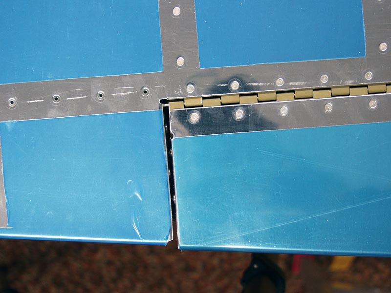

Well, the trim tab came out perfect and I'm really pleased with the
mating to the Elevator. That being said, I'm less than pleased with
the for/aft alignment of the Trim Tab. The Trim Tab hangs past the
Elevator trailing edge by about 1/8" of an inch. It is 1/8" along
the whole distance of the Trim Tab. In looking at the cause, it
appears that the skins are all cut such that you are suppose to use
the roundy part of the hinge and not the square cutout when aligning
the hinge for drilling. This would account for 1/16" on each side
and would add up to the 1/8" overhang I'm seeing. Grrrrrr....
What should I do, fellow builders? I could drill out all the rivets
and use a new hinge, and I'm certainly not opposed to that. But am I
making too big a deal out of the whole thing? Or is everyone gonna
look at it forever and go, "Hey, how come your trim take is too long?"
Bummed Out in Livermore
Matt
RV-8 #82880

Are you sure you've got the right size pin in there? The loops don't look
like they align right. After that, just set it aside until the end of the
project and then see how you feel about it. It's pretty minor and your F-it
factor changes over time;-)

That's so minor that you are the only one that will ever notice it.
Functionally it makes no difference whatever. Keep it as is, continue
building and if it really bugs you change it after you get the plane in the
air....some things are not worth fretting about, and this seems to one of
them.

Looks good. Don't dwell on the small stuff you will never get done.
Mike Ice

BTW the trim is very seldom aligned perfectly when you are parked so
most likely we would
have never known except now you have told us.
Jerry

Hey guys, thanks for all the great feedback. I think I'll just set it aside for now and fry some bigger fish, and then come back to it later and see how I feel about it. Jerry's comment about the tab never being aligned very often sitting on the ramp made some good sense. Then again, on picture day....
Thanks!

Thanks to everyone for all the great feedback on my trim tab
woes. The more I looked at the 1/8" over hang of the trim tab, the
more I couldn't stand it! So I ordered up a new hinge which came
today. Drilling out the rivets wasn't too bad. I used a nice
straight piece of wood taped to the trailing edge of the Elevator as
a reference, and then redrilled the new hinge. Attached is a
"before" and "after" shot. Ah, much better! Now I can sleep at
night. All and all it was pretty easy.
I making too big a deal out of the whole thing? Or is everyone
gonna look at it forever and go, "Hey, how come your trim take is
too long?"
Matt
RV-8 #82880
