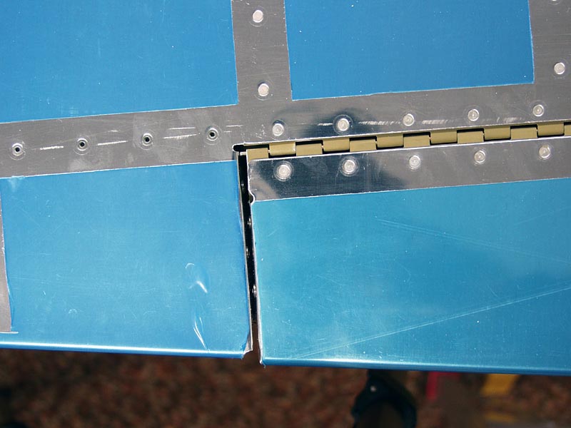

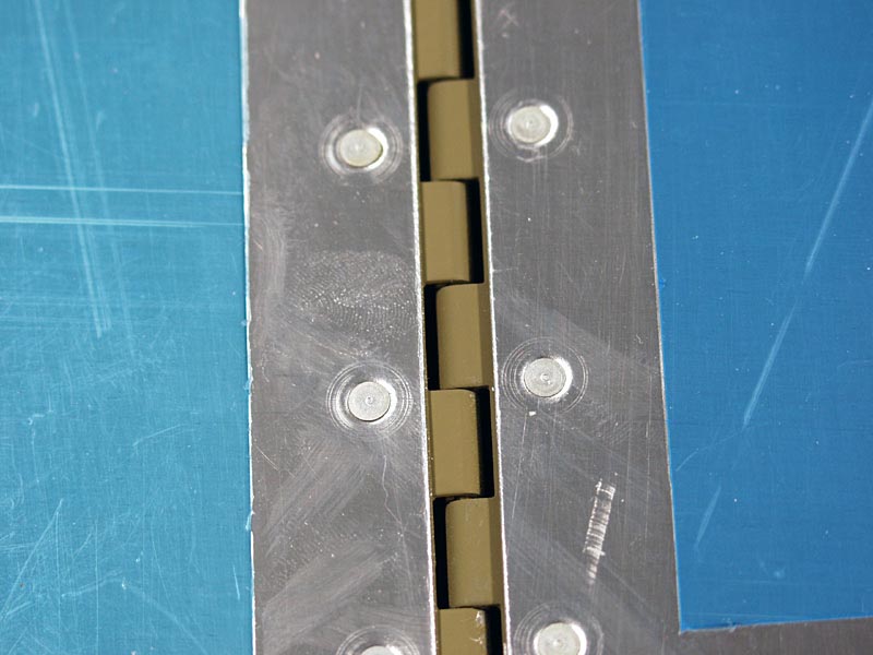

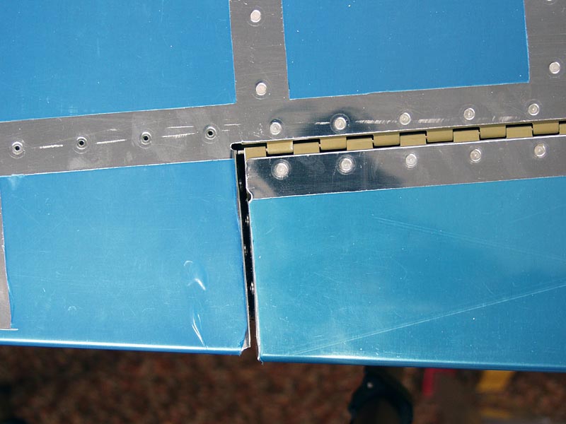

Listers,
Well, the trim tab came out perfect and I'm really pleased with the
mating to the Elevator. That being said, I'm less than pleased with
the for/aft alignment of the Trim Tab. The Trim Tab hangs past the
Elevator trailing edge by about 1/8" of an inch. It is 1/8" along
the whole distance of the Trim Tab. In looking at the cause, it
appears that the skins are all cut such that you are suppose to use
the roundy part of the hinge and not the square cutout when aligning
the hinge for drilling. This would account for 1/16" on each side
and would add up to the 1/8" overhang I'm seeing. Grrrrrr....
What should I do, fellow builders? I could drill out all the rivets
and use a new hinge, and I'm certainly not opposed to that. But am I
making too big a deal out of the whole thing? Or is everyone gonna
look at it forever and go, "Hey, how come your trim take is too long?" Sad
Bummed Out in Livermore

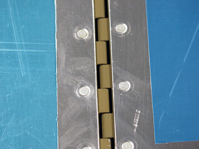

Matt, my plans are at the hangar, so I can't check for sure, but my
guess is that your problem is with the gap / overlap of the hinge
itself, too much hinge is exposed. Take a look at this picture, and
you can probably see what I mean. Drill it out, get new hinge, line
the trailing edge of the elevator and trim tab up using a straight
edge, and drill it again.

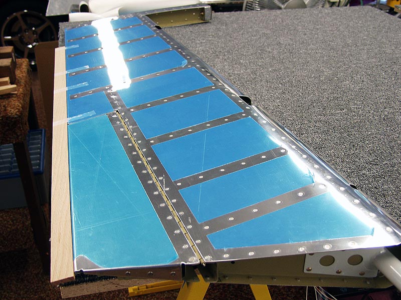

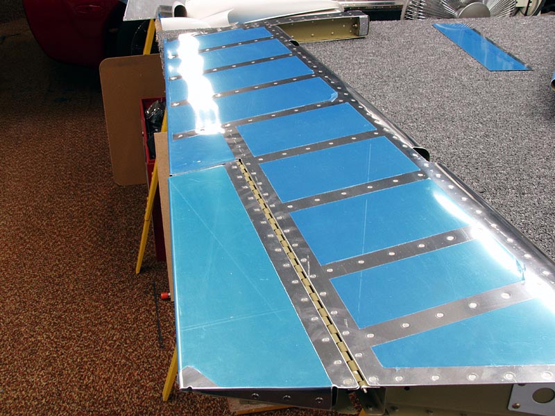

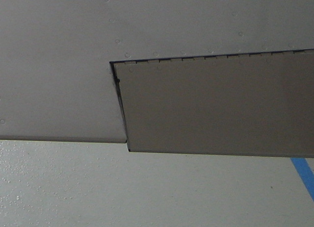

PostPosted: Sat Aug 09, 2008 5:09 pm    Post subject: BooHoo - Trim Tab Alignment... Reply with quote

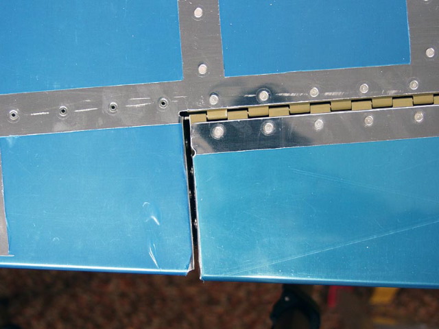

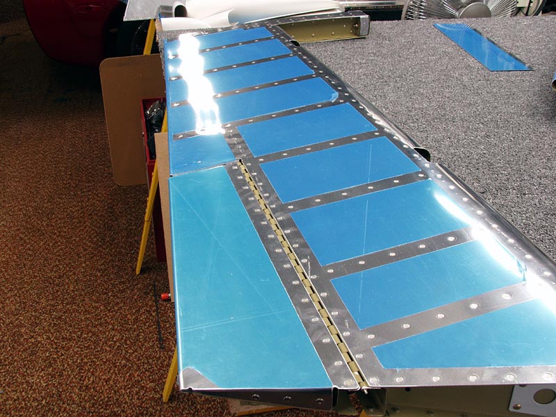

Dear Listers,
Thanks to everyone for all the great feedback on my trim tab
woes. The more I looked at the 1/8" over hang of the trim tab, the
more I couldn't stand it! So I ordered up a new hinge which came
today. Drilling out the rivets wasn't too bad. I used a nice
straight piece of wood taped to the trailing edge of the Elevator as
a reference, and then redrilled the new hinge. Attached is a
"before" and "after" shot. Ah, much better! Now I can sleep at
night. All and all it was pretty easy.

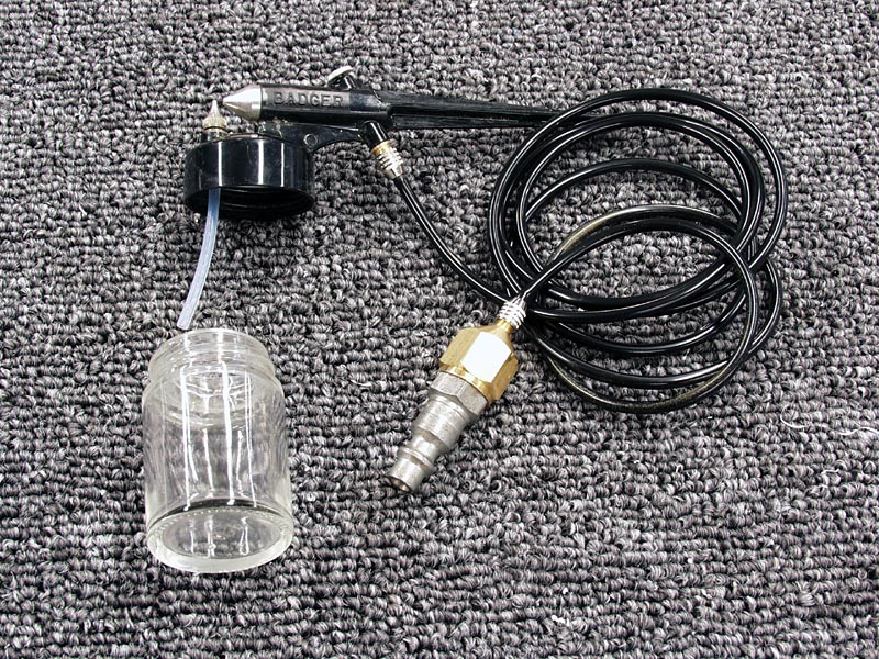

BTW, I picked up a small "air brush" by Badger this afternoon at a
local craft store call Richards. It has a little glass bulb to hold
the paint and with an adapter, hooked right up to my air
compressor. Three drinking straws full of Variprime plus three
straws full of activator was all I needed in the little air brush to
very nicely prime the two pieces of replacement hinge. Clean up was
easy and fast. Great for those "one-off" priming jobs. Just a
little tip from your Uncle Matt... Smile
