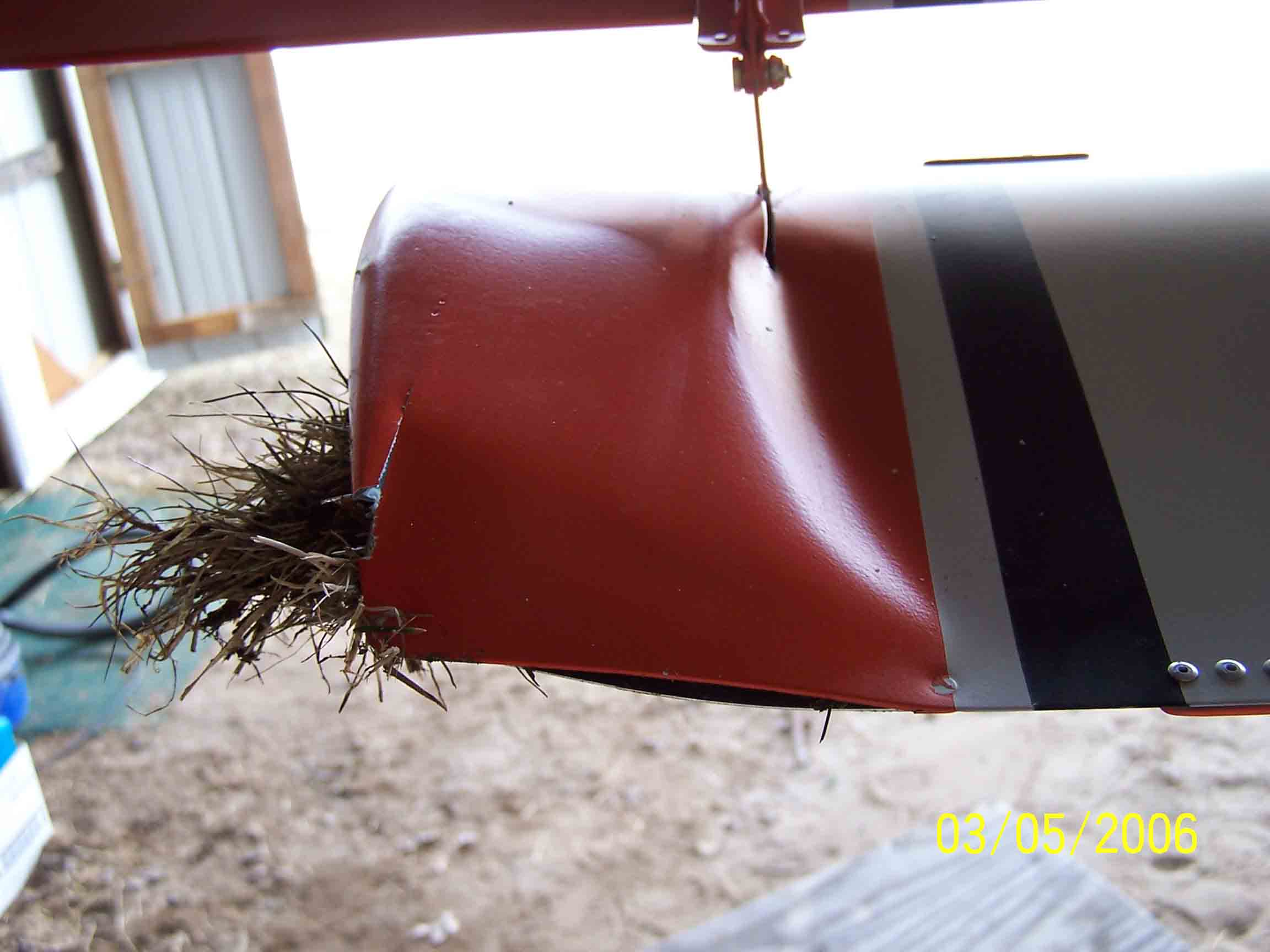

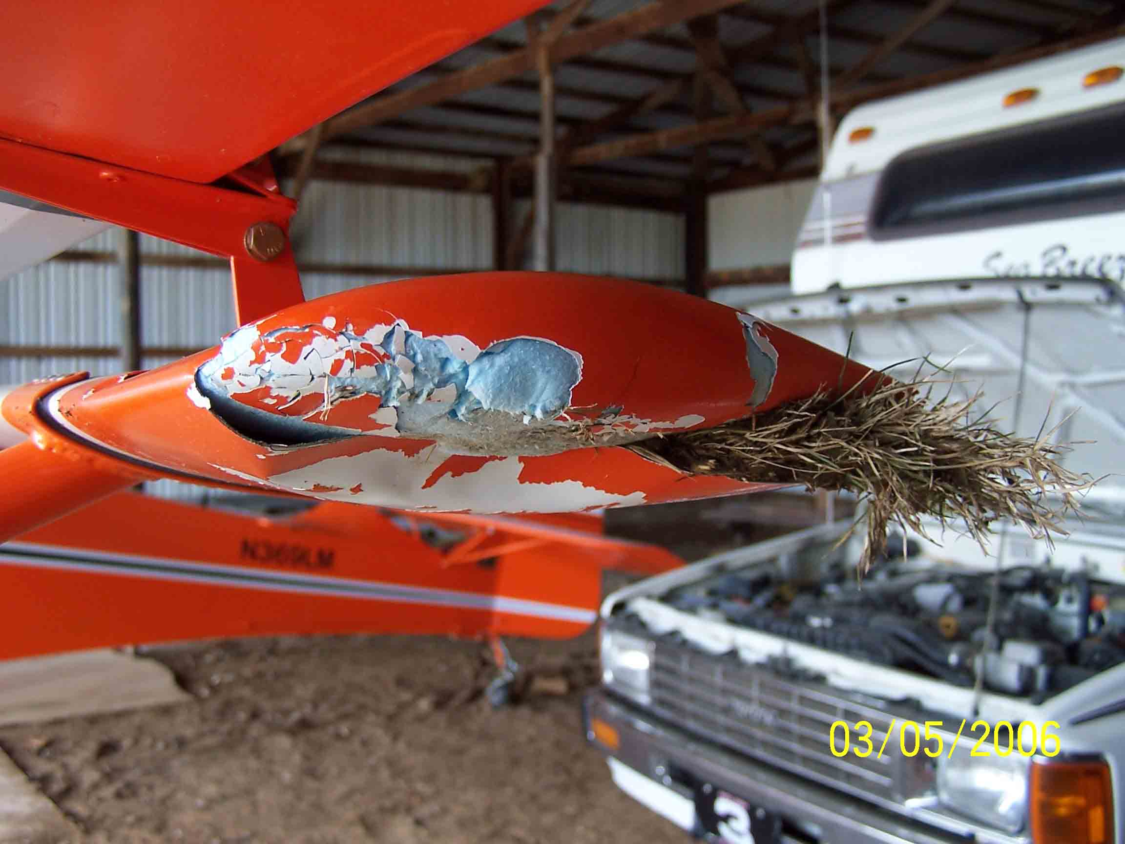

Went up last night for what was supposed to be my last lesson before getting my tailwheel endorsement. Went over to do some hard surface work, and the first two landings were squirrelly. Third landing the aircraft just darted left, with full right brake and rudder nothing would stop it. Right flaperon touched the ground and the tailwheel is cocked to the left. CFI thinks the bolt on the tail wheel broke and that is what caused it to shoot left, but I'm not sure. Landing on pavement the aircraft was really grabby. It will take some convincing before I want to go on pavement again. Need a 12 step program; loppers anonymous.
Ryan Wheeler

You are right, I've not read that. I purchased the aircraft a few weeks before Oshkosh, so I have very limited experience with the aircraft. I don't see an online store, but I'll e-mail the McBeans about it.
Some damage to the plane, but I don't think I'll be rebuilding a wing or anything. The wing and flaperon looked and felt solid and straight. There is a rip in the wing fabric and I think I noticed some damage to the right side of the turtle back. So, Ill need to look into that further. The big noticeable item is the tail wheel. I'll have to bend the horizontal tabs back in place and then try to get it realigned before replacing the three bolts with new. Guess it could be worse, but definitely not fun.
Ryan

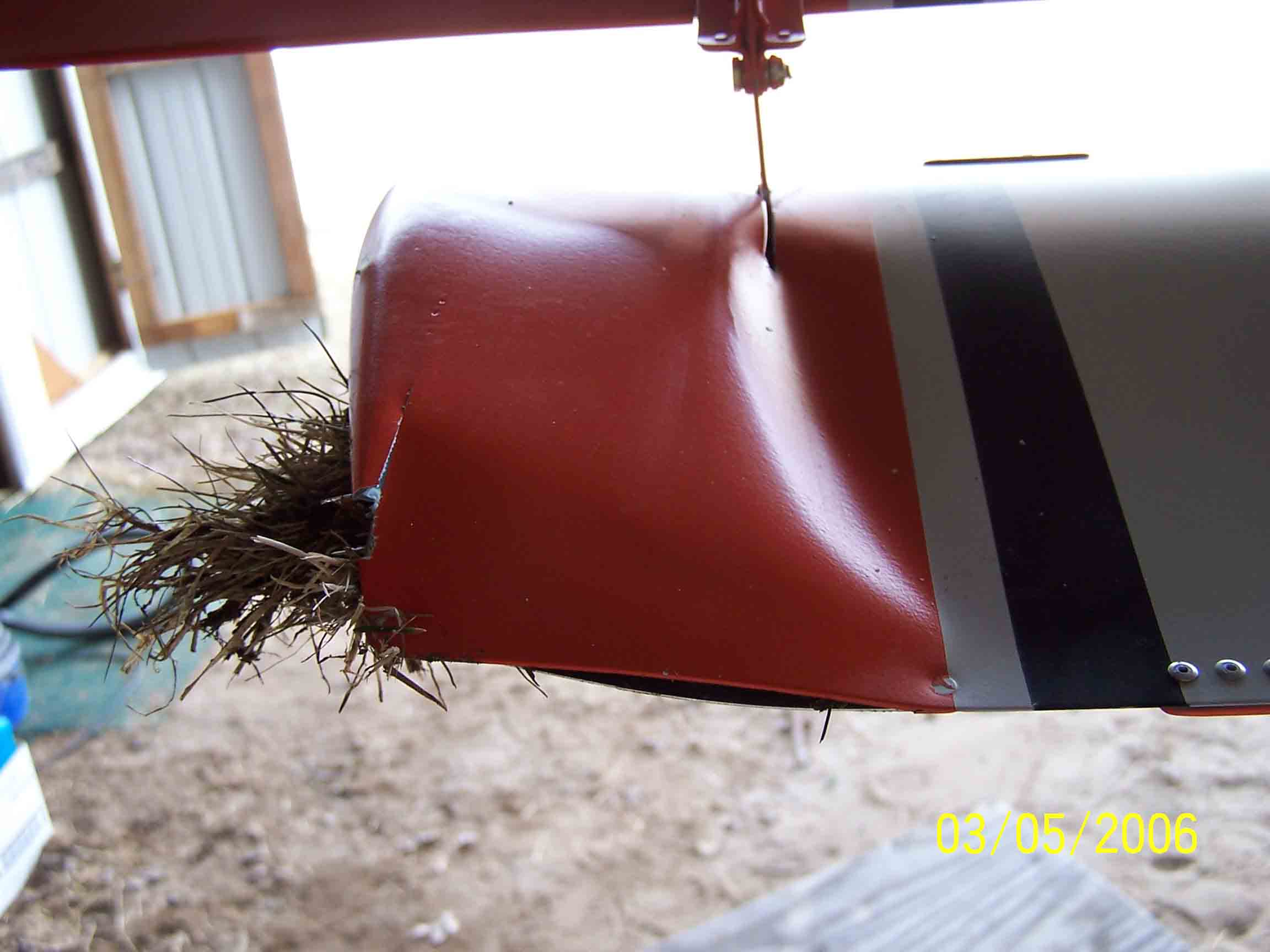

Cheer up, Ryan....my attempt to teach myself to taxi ended up like
this, a week before my DAR visit...all was repairable, and it came
out looking pretty good. It wasn't a ground loop, but a side gust and
a dumb rookie who shouldn't have been doing what I was doing...going
too fast and trying to see if the tail was up (it was) and then
pulling back and probably some to the left, too.
Lynn Matteson
Kitfox IV Speedster
Jabiru 2200
Status: "Condition grounded, but determined to try." (Pink
Floyd..."Learning to Fly")
