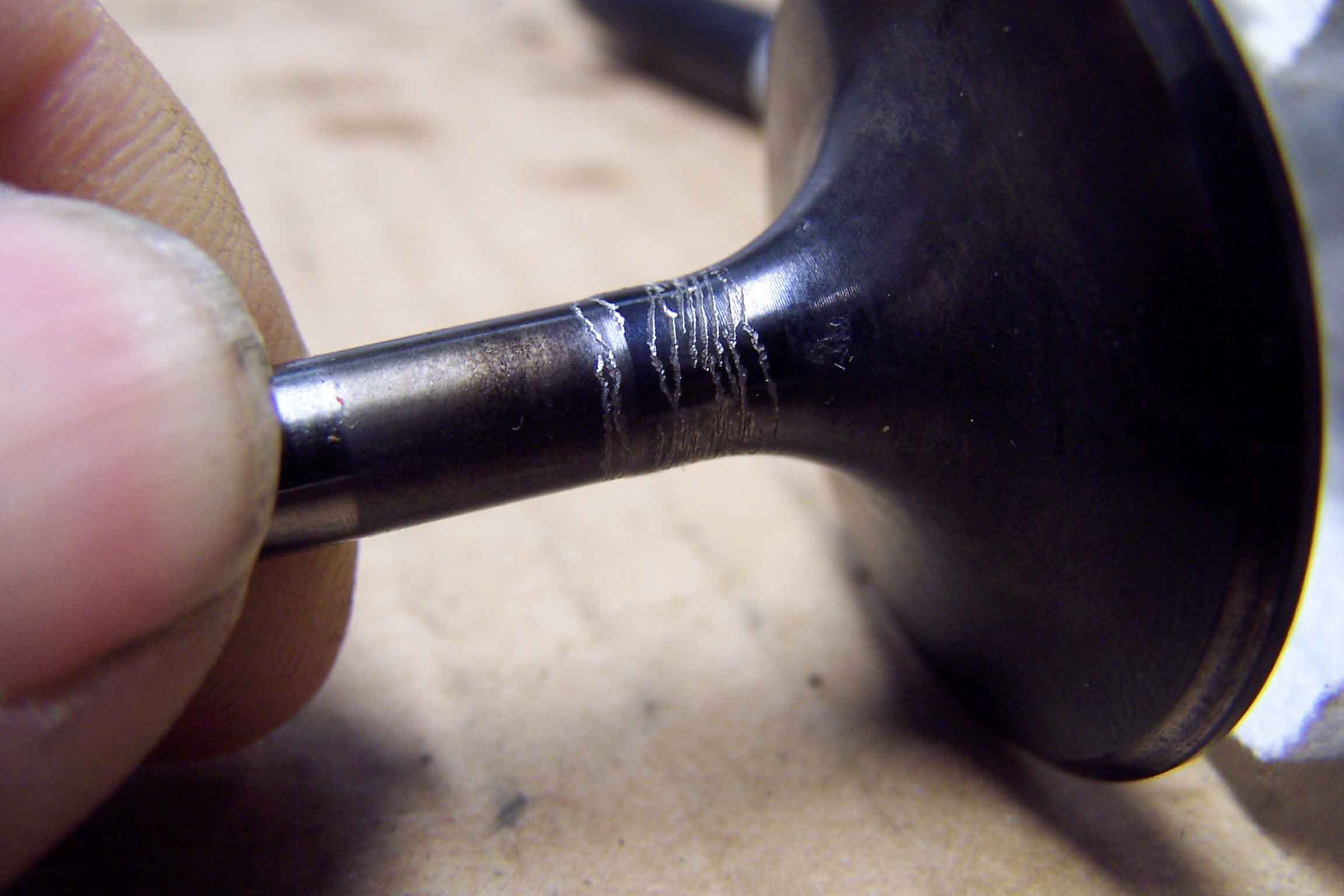

I think the only contaminant that got between the teeth was another
one of the teeth. : )
Even the intake valve that was hit by the piston is still without
runout when spun in my lathe, but a local aircraft engine rebuilder
magnafluxed it and said it looked like it had cracks, but that it
might have been where the head was spun-welded onto the stem, and
that he would not use it. And to that I gave a big amen, 'cause I
sure as hell WASN'T gonna put that back into the engine, even if I
got a "good to go report" from the magnaflux check. See picture:
I certainly didn't need the 'flux job to tell me not to use this
valve, but I also couldn't determine what the "scratchy-looking"
marks were. My best guess is that very hard metal was flexed, and
where the flex occurred, the edges flaked off, leaving a slight
crater which shows up as a scratch.
The guides are worn to their allowable tolerances, but the valve
stems are right on specs. The valve "wobble test" told me more than
the micrometer did, and I plan on getting the heads done...new valves
and guides. The local aircraft engine guy said he thought they'd make
it to the 1000 hr suggested head overhaul time, but certainly not
with the one valve looking like it does. His estimate was based on
the appearance of the guides, valves, and the wobble test, and his
experience in the field.

Posted: Sun Aug 10, 2008 6:04 am Post subject: Landing and engine pictures |
That valve appears to be ready to let go at any time, Lynn. Good catch!
Deke Morisse

Stevie Wonder could'a caught that one, Deke!
A little update on the repair process....the word back from Jabiru
was not encouraging, and I'll leave it at that. (I want to first see
if it's ok to pass along what was said)
At this point, I've got the engine completely disassembled. I had
done a run-out check on the gear end of the crank, and found .0015"-.
002" run-out. This could have caused the gear to fail, or could have
been caused by the gear teeth being wedged between the crank, the
remains of the gear, and the gear housing. Either way, run-out is run-
out, and the Jabiru engine manual doesn't give the accepted amount of
run-out. I'll have to consult with them on this measurement. Most
other measurements are within specs, with the exception of the valves/
valve guides. I'll have a valve job done, or if I don't get a "warm
fuzzy" feeling from what I perceive,(that is, do they do it, or send
it out to their local automotive guy) I'll get the parts and do it
myself or have it done by the local aircraft engine rebuilder, if he
would even take it on. This guy is a good friend of my flight
instructor, so we'll see what gives when that time rolls around.
There is always the possibility that I can get a factory rebuild, if
it turns out that this crank is out of specs due to the run-out
issue. The crank in all other aspects is perfect....no wear, bearings
and crank bearing surfaces are primo, and it looks like it would
easily go the rest of the 1500 hrs to the 2000 hr overhaul time.
