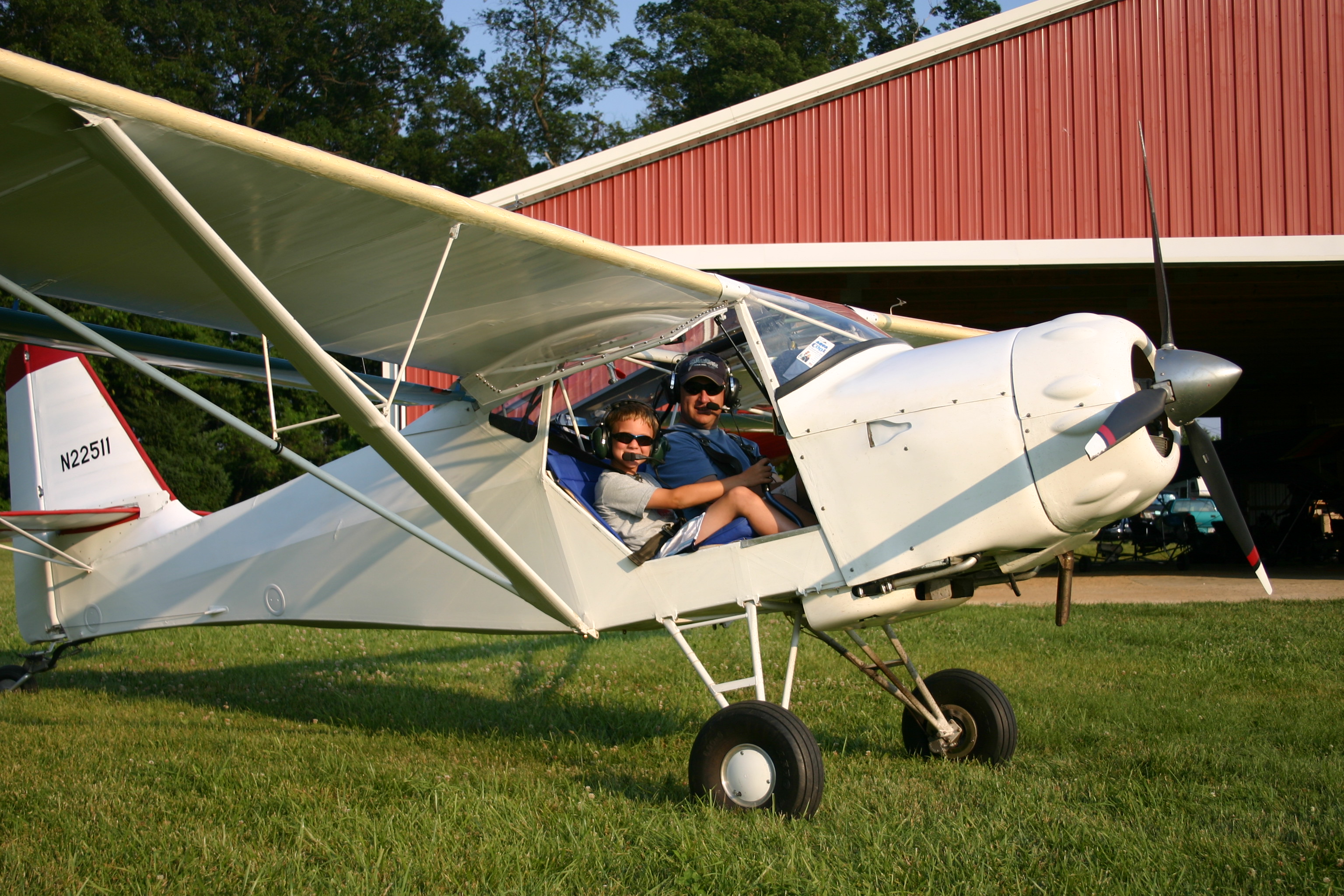

The placement of mine might be in the wrong place right now. I looked at several photos of Doug Kelly's Kit fox and put them where they did.
The other week someone pointed out that there was a outline on the cowl painted over that was directly in line with the area where the front half of the engine cowl had a attachment point and no exit for the engine air( hot air). On a normal day below 80 degrees it is just fine but on the high air density days the air coming in is warm that is till you get to 3K ft. I just free handed my vents and molded them in place.
I spoke to John King and he said that he just opens the door 3/4 of a inch and it is plenty of air. So maybe the next person will not go through putting them in and just open the door a little (KISS).
