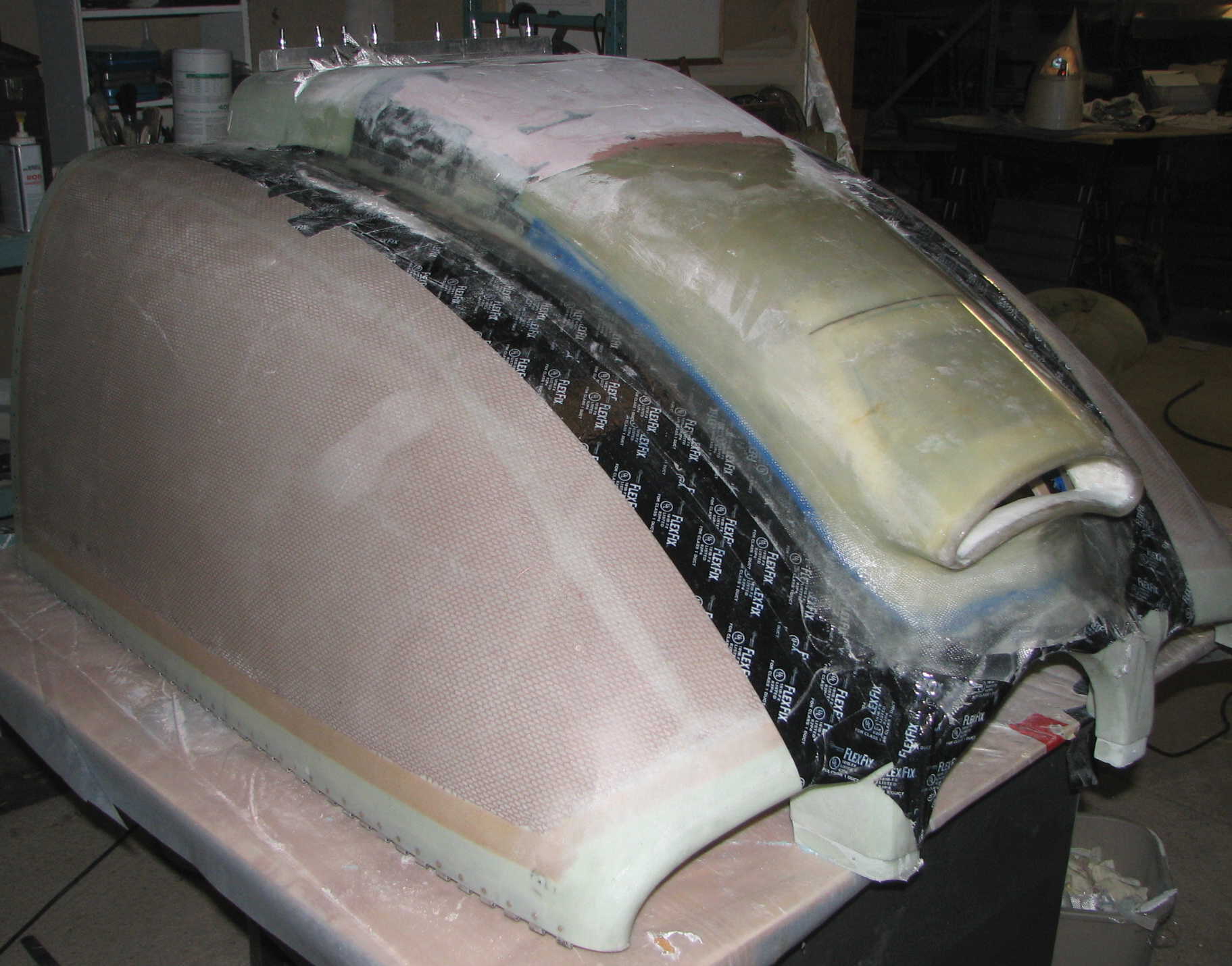

robin1(at)mrmoisture.com Guest
Posted: Tue Aug 26, 2008 12:51 pm Post subject: James cowl with a standard IO-540 |
Danger Will Robinson, Danger Will Robinson!

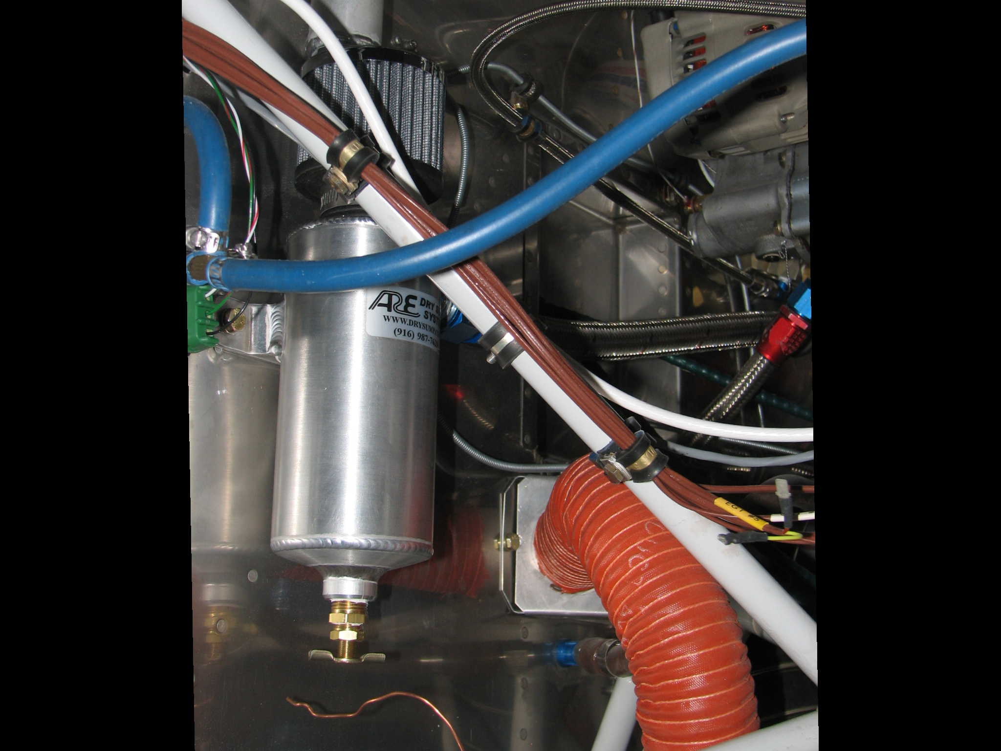

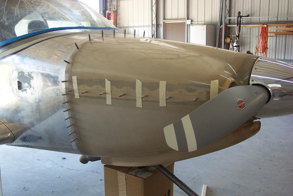

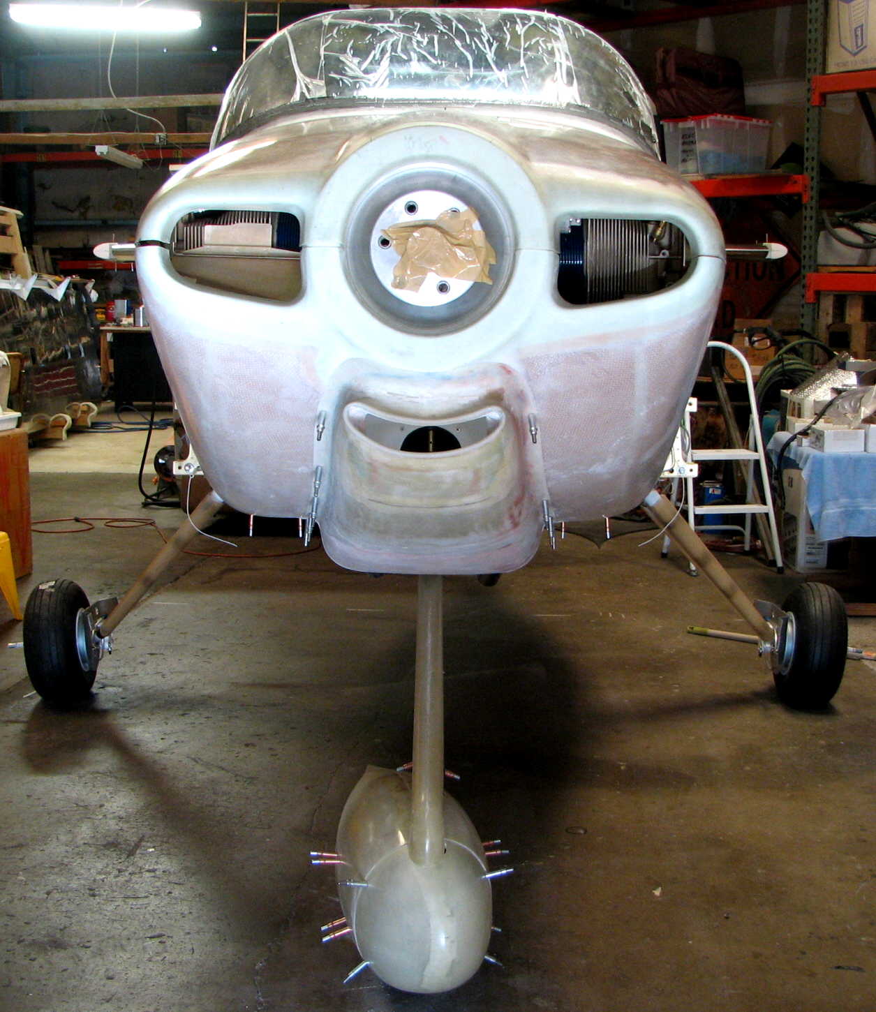

Michael it would be great if life were that simple... For those that don't know I have:
<![if !supportLists]>· <![endif]>BPE IO-540 w/ Cold Induction
<![if !supportLists]>· <![endif]>James Plenum Installed
<![if !supportLists]>· <![endif]>James Cowl Installed
<![if !supportLists]>· <![endif]>Airworthiness certificate in hand
<![if !supportLists]>· <![endif]>First flight ~2 weeks
Sheril & I spoke extensively with Rod (amazing builder) before & during OSH this year and there is NO good news. There is absolutely no way that Rod's unit will work with the James cowl and the BPE Cold Induction. The space between the standard “Smile” air inlet and the injector body is just too short. The angles are all wrong and the spun canister conflicts in a major way with components on the underside of the engine and the lower cowl. A major modification to the James cowl much like Deems did would be required. Our goal was to leave the “Smile” air inlet shape unaltered.
Also of note there are a couple of different Forward Facing Cold Air Induction systems available from BPE. I happen to have the latest design which is different from Deems. Additionally there are different Injector Body sizes. Mine is 3.75" known as the Model 300 while Deems has the Model 200 which is 3.25". (sizes by memory). James did not know about the different Cold Induction systems or the different size Injector Body units. His response was “REALLY? Can you measure again?”. One additional note is that both James have a bit of 2 week-itus. They have been waiting for a customer to develop a system and then send them a copy to use as a basis for designing their system. IMHO you have a shaky business model if you require your customers to be responsible for your R&D.
The largest challenge with the James cowl installation is the air box. We believe we have come up with a solution that is simple and straight forward. Our design is not 100% complete and I don’t have photos (yet) of the transition from the Injector body to the Air Filter but I should have them soon. Attached are photos of the forward portion of the air box / filter mounted to the cowl very close to the air inlet. The angle of the filter allows us to drop the lower cowl away from the portion of the air box attached to the injector body. Note that the injector body is less than 3” away from the filter. If anyone saw the Bower unit there is no way it would come close to fitting in this space.
General notes on the James Cowl. Deems has a good write up on general fit however we seemed to have different issues when fitting our cowl. There was absolutely no way to get the lower cowl to fit as is. We could get the front & right to fit but not the left. Or the left & front to fit but not the right. We fussed with it for 2 days with no luck. When all else fails pull out the saw! We split the lower cowl on the centerline of the cowl starting from the exhaust outlet (nose wheel leg slot) and ending up 5-6 inches from the scoop. This large split allowed us to easily fit all sides and give the cowl enough “relief” to attach w/o any tension. 2 hours total time once we chose this path. All that was left to do was patch the “V” void and the cowl fit perfectly. (Cowl Filter 3.jpg shows the lower cowl split patch)

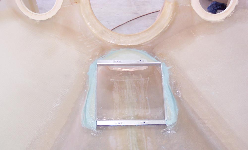

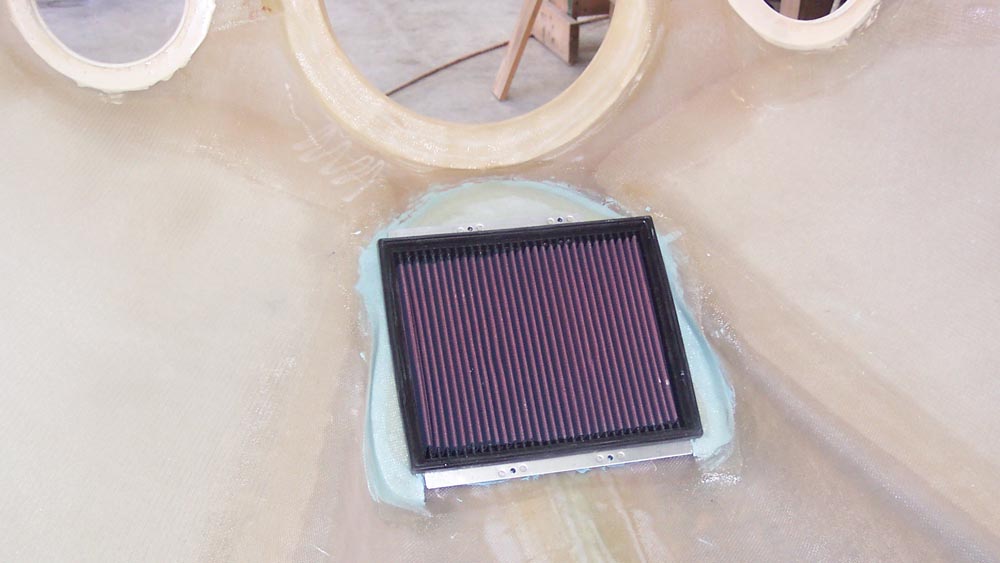

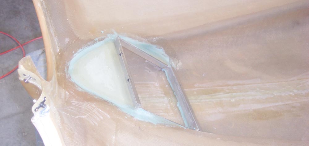

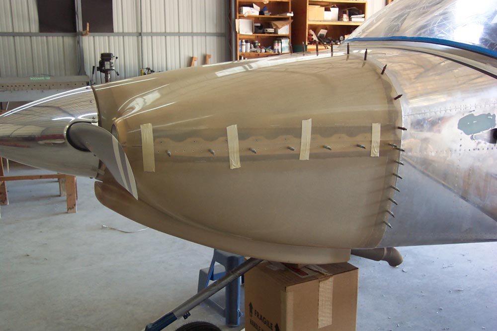

Ok, I'll fess up with what we did. For cold air induction we used the std Vans cowling.... but also purchased a scoop with K&N filter kit that they use on the F1 Rocket. I have quite a few pics on the process... so if anyone wants more let me know. Attached are the basics.
Don McDonald
#40636
