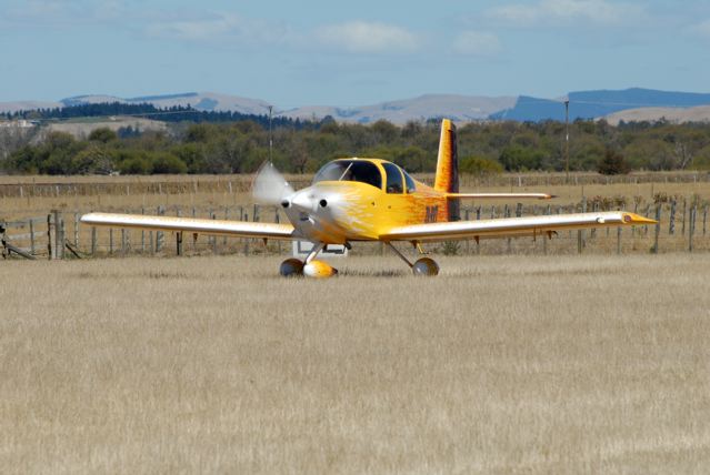

PostPosted: Sat Aug 30, 2008 7:26 pm    Post subject: James cowl with a standard IO-540 Reply with quote
Hi Guys
Just done a couple of quick tests this morning.
By way of background we have the IO540 from BPA dynoed at 282hp. A
wonderfully smooth combination.
MT 3 blade prop.
James cowl with plenum.
The plenum needed a fair bit of work.
The cold air induction & filter was definitely time consuming & not
straight forward. But we have a K & N filter, the same as Gary's, and a
top flap for alternate air. A pair of working mags.
1/2 fuel, 2 adults, 3 children+ clutter.
Full throttle.
8500ft,
7410 DA
155 KIAS
172 TAS
22.7MAP
2340 RPM
2 runs, both cross wind, averages.
PS - we fly off a grass 550m strip most of the time, with absolutely no
probs, except when very wet. The landing lights need to be a pair,
brighter, and centre mounted (somehow) - maybe on the cowl under the
air intake?
PPS - it was very dark when we landed late last week under heavy
overcast & rain.
Neil
ZK-RVT
