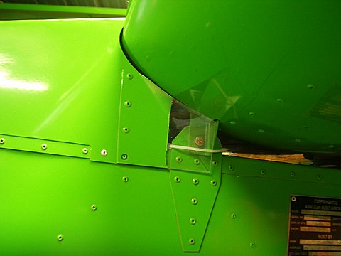

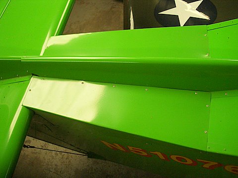

>My next project is to fabricate strut fairings. I have looked >at
| Quote: | different options but I think I will go with making them out >of .016
6061-t6
That's what I did. It was quite a bit of work but well worth it as has been documented here before. When the strut fairings are combined with the no slats/vg's the plane feels like it's been set free. The only thing I have found that some might fault is the glide angle is much flatter of course because the drag is so dramatically reduced but the thing slips so well with the slab side that it's of no consequence. Rpm/fuel burn/noise/engine wear/buffet are all down, some dramatically...a vastly improved airplane.
Speaking of buffet; there are lots of opportunities for simple cleanup in the tail area, where it seemed a lot of the airframe buffet/vibration was coming from on mine. I faired in the nasty pocket under the rudder leading edge with foam and bondo, and under the HS leading edge with .016 and of course the VGs under the elevator. What a difference.
All those little cleanups add up to free fuel.
Joe

nyterminat(at)aol.com Guest
Posted: Thu Sep 04, 2008 8:06 am Post subject: Slats |
Joe, Could you post some pictues of the cleanup of the tail area?
Bob Spudis

ricklach
Joined: 20 Jun 2006 Posts: 127 Location: Kernville, Calif.
Posted: Thu Sep 04, 2008 8:13 am Post subject: Re: Slats |
Hi Joe,
I’ve been thinking about cleaning up the tail area where the Rudder, horizontal stabilizer and fuselage come together. It sounds like you have done just that. I would love to see some pictures of what you did and a little more conversation as to the results. Some people think trying to clean up a box like a 701 is a waste of time, but I think any improvement gained are free performance gains.
Rick

jpspencer(at)cableone.net Guest
Posted: Thu Sep 04, 2008 9:39 am Post subject: Slats |
>I would love to see some pictures of what you did and a >little more conversation
I will send a few pics to somebody who already knows how to post them and they can post them if they like. I'm a little short on time right now trying to get things together for a trip...who wants them?
I tried to measure a speed gain with the tail cleanup and kept getting varying results since it's so small it's hard for me to accurately measure...the one that came up most often was 2.25 mph IIRC. Not definitive but indicative. Call it a couple mph...not a whole lot but it adds up and it's near free and did make it smoother. And it looks better to me and is light. As far as cleanup on this plane being a waste of time goes...it's SO crudely done that it can be easily improved. I never consider free speed/efficiency a waste, personally.
Joe

NYTerminat(at)aol.com Guest
Posted: Fri Sep 05, 2008 2:52 am Post subject: Slats |
Joe sent me some pictures to try to post. I'll give it my best.
Bob Spudis
In a message dated 9/5/2008 12:05:57 A.M. Eastern Daylight Time, aa9td(at)verizon.net writes:
[quote] Joe can you send some pictures of how you cleaned up the the tail of the 701 Bob aa9td(at)verizon.net (aa9td(at)verizon.net)
