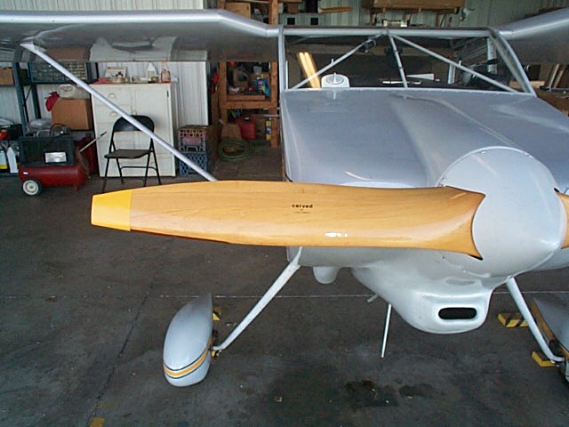

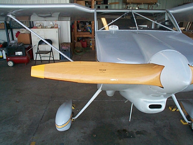

Nice looking TW! What kind of adhesive did you use to bond the plexiglass to the Lexan?

Curt
I had a similar thing to happen on N6PJ years ago. See the attachment to see how I cemented a plexiglass patch around the filler hole and painted it white.

I thought you'd ask that and I don't really remember. That was about 15 years ago I think but it seems like it was a paste type adhesive that was touted to be for plastic. Sorry I cant do better than that.
Good luck with your fix.

You may try at an aquarium supply store or pet store for aquarium repair parts. It would be worth a phone call or 2 I'd say.
