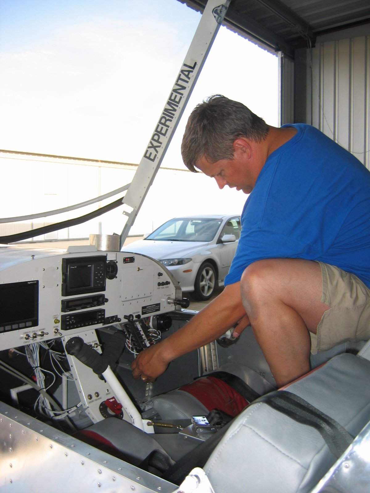

Everything on my 601XL is fuses except for the alternator, flaps, trim and starter (i.e. things with windings) My fuse box hinges under the instrument panel so it is out of the way, yet accessible. Attached is a pic of me accessing the fuse panel.
I used a hybrid of Nucholls's Z-16and Z-20 schematics for an overall design. It has working out well for 32.0 hours of flight so far.
