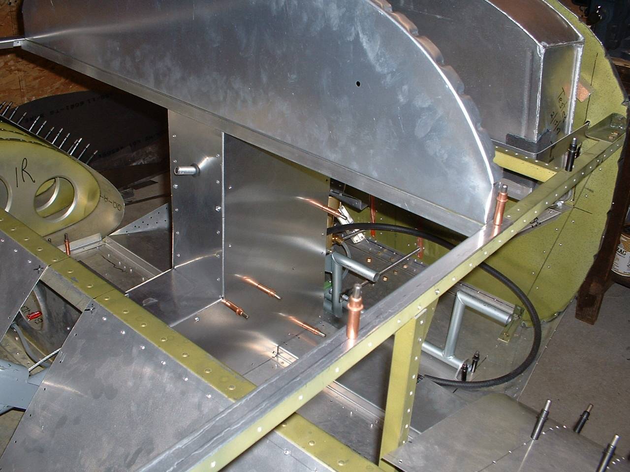

Just sprung (Sprang? Emptied my checking account!) for a Dynon D-100. It comes with a remote compass. I'd normally ask EAA, but they're closed today. Do I still have to have a whiskey compass? I have a nice Airpath, but what's the sense of taking up panel space and weight if I don't have to? The D-100 also has a build in voltmeter, so I might have some brand new or like new instruments up for sale.
I've been to several hardware stores and spent hours on the net but still can't find a handle for my header shutoff. Well, I could use a plumbing handle, but you can imagine the razzing I'd take for the "H" or "C". Has to fit over a 1/2" rod. It shouldn't be threaded- I'll either modify it with setscrews or a drift pin. Any ideas? Picture attached. Remember, on an HDS this is all scratch-built stuff so I don't have a clue.
Finally, I haven't been able to find a decently priced, functional used Mode C transponder for weeks. Any leads appreciated.

I have a $10 Walmart compass stuck to my canopy. It's an Airguide brand, weighs a couple of ounces and is marked in degrees as well as the eight cardinal directions. It has compensators to zero it out and it works like a charm. If your DAR won't sign off without a compass, this one should do fine.
For the fuel valve, you could grind flats into the end of the shaft and drill and tap the center for a screw and then the handle off a ball valve might fit it. Or you can make a handle out of a piece of flat stock by cutting a hole in one end to fit the end of the shaft and secure it with a screw and washer.
For transponders, you might try eBay: http://tinyurl.com/3fuh9v there's a few of them listed there.
