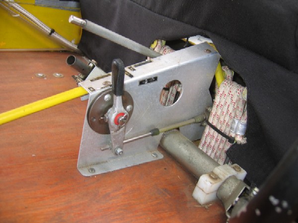

I have dug out some build documentation - two MANDATORY modifications issued by the PFA. The first describes adding the horizontal trim tab for those who have already built the stabilisers and those that hadn't, mine has completely reworked tubing on the starboard side to allow for an inbuilt tab.
The second states: "Original equipment on Kitfox does not provide for a positive location 'gate' on the flap control lever. It was original intended that the plane be trimmed by use of the flaps. However flight tests indicate a more suitable situation would be to use a trim tab (adjustable) on the elevator and use the flaps as flaps only. This is the recommended practice. In this situation 15 degrees of flap is the maximum required in any situation. Hence a suitable gate is required that can be clamped to the diagonal tube framing floor to seat that will restrain total flap lever travel to 0 - 15 degrees in say 5 degree steps"
Mine has 3 notches: 0, 15, and something between. The first "notch" adds about 90% lift and 10% drag (% of the total effect), used for short take-offs and nose-down on approach. The 2nd notch (15) adds 10% lift and 90% drag. I'd have to guess that your adding "10 degrees or less" is adding a *lot* of drag at cruise speeds. I never use flap until I am down to about 55 mph approach speed, or remove it until well off the ground on take off; in fact it is placarded never to use flaps at all above maneuvering speed, 70 mph.

I have no "notches" on my flapperon lever. It's a continuous range from 0 to a stop at about 15 degrees which, I think, is where the "flaps" begin to interfere with operation of the ailerons.
I'd like to see your tab set-up. Is it like the one on the Euro-Fox?

Lucky for you I already have some pix I had sent to another poster off-list 'cause it's pissin it down out there at the moment
I haven't seen the one on the Euro-Fox but I do know the UK Fox has a lot of mods to the original kit. I seem to remember the normal (US) flaperons are meant to be limited to around 23 degrees but I might be wrong.
The picture of the "console" shows the continuous horiz tab setting nearest and the flap handle (with the release button on top) is on the far side, set for zero flaps in the picture. I never use full flaps until I am lined up on final, at that setting it is easy to run out of roll correction if a turn is too steep on base to final. Had it happen a few times early on!

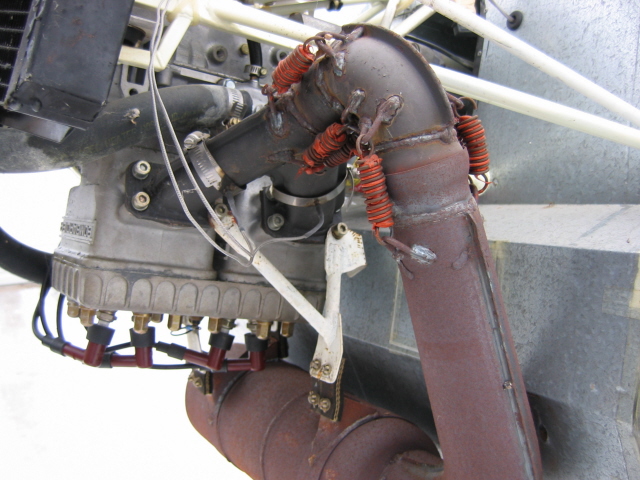

I use the Grand Rapids Technologies EIS system for engine data. I love it as it has an alarm system that whacks me in the head (visually) when my EGT's go over red-line; (or anything else for that matter.)
The easiest EGT probe to install would be the P-110 hose clamp mount. Mine are P-111 mounted via a 1/8" NPT to 1/8" compression fitting screwed into the exhaust manifold. Check your exhaust manifold. It should have two bosses welded on the top or bottom about 2" from the engine flange. These are for the EGT probes.

| Quote: | If you use the hoseclamp style EGT probes, all you have to do is
drill two 3/16" holes in the Y pipe.
Yes, drilling the holes is easy. I can't picture the clamp,
though. How'd you do that?

thesupe(at)hotmail.com Guest
Posted: Sun Oct 05, 2008 8:04 pm Post subject: 582 Oil Reservoir |
Sorry if someone beat me to the answer C but picture a Y The holes are in the two upper arms of the Y. The probe goes through a hole in the hoseclamp C into the hole in the Y and the clamp is tightened arould that arm of the Y. Same thing on the other upper arm of the Y pipe. Hope that makes sence. If you saw it it would be obvious immediatly. Jim Chuk 4 building MN
| Quote: | Date: Sun C 5 Oct 2008 19:15:23 -0700
From: bnn(at)nethere.com

I can picture the clamp (attached)
Posted: Mon Oct 06, 2008 5:20 am Post subject: 582 Oil Reservoir |
I should have thaought about haveing pictures that show this last night C but better late than never they say. This was a picture of my Avid MK IV with 582 before I changed it to the Jabiru engine. Also C look at the probes in a catalog C they come installed in the hose clamp from the factory. Jim Chuk Kitfox 4 building Avid MK IV flying Mn

matronics(at)bob.brennan. Guest
Posted: Mon Oct 06, 2008 6:08 am Post subject: 582 Oil Reservoir |
That is how I pictured it Jim, although maybe a bit closer to the cylinders, not that it probably matters.
It looks like there is some discoloration at the probe holes, probably from exhaust escaping? That's why I was thinking a bit of manifold goop-sealer-stuff might be a good idea(?)
Also - is the picture upside down or the engine?
