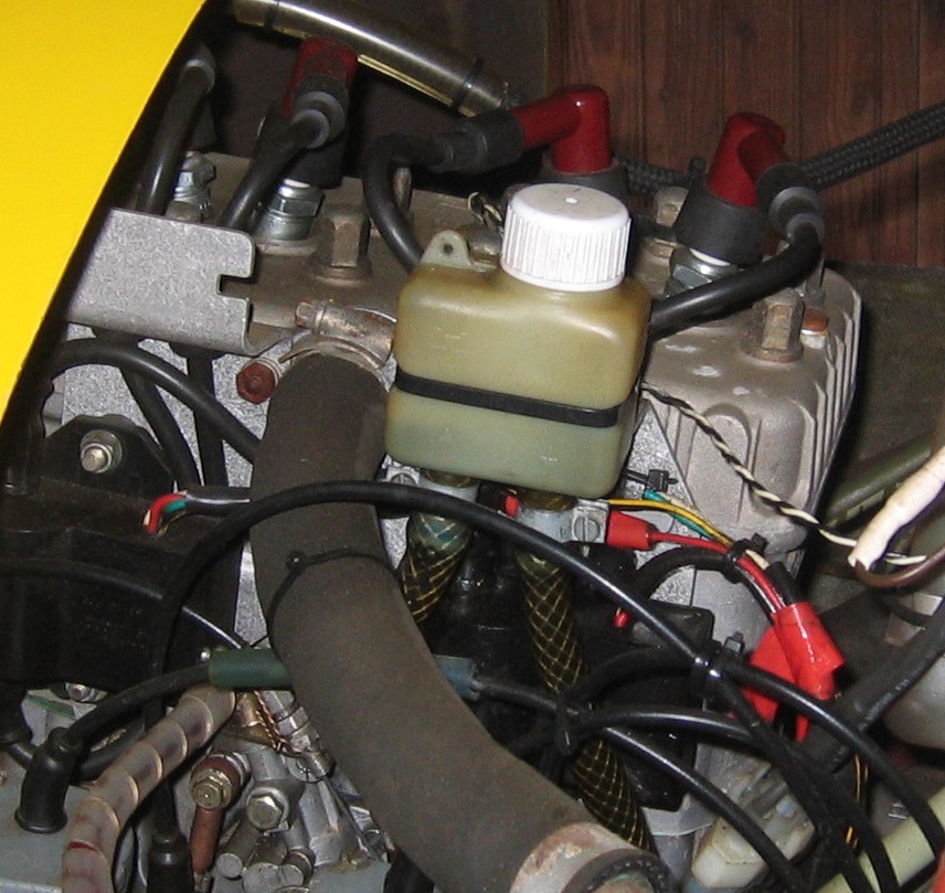

Third picture is the whats-it. Obviously a reservoir with some sort of lubricant which hasn't gone down since I have owned the plane. Obviously something I need to know about and service.

The other little reservoir is for the water pump/rotary valve shaft. If you haven’t noticed it going down then all is well. If the oil in it turns milky your RV shaft seal is toast. There are specific instructions for bleeding the injector pump and the RV shaft in the Rotax Manuals available from http://www.rotax-owner.com/ Check the tabs for engine manuals and download your manual in pdf format for your engine.

I didn't see your original post but the (Whatsit) sounds like the oil reservoir for your Rotary Valve lubrication.
Is it the small plastic bottle mounted on the aluminum angle above your CDI units?
If so this is a circulating lube system supplying a flow of oil to the rotary valve. If everything is in good order you shouldn't see the level drop. Also the cap has a rubber seal in it wit a small slit cut to allow pressure relief. Make sure you never replace this with a full seal as it will cause you some real pain.
I used to just take out the oil from the reservoir with a syringe about every 50 hrs and replace it - probably overkill but for a couple of ounces of two stroke oil I figured it was cheap insurance.

The same 2 stroke oil that you run in your fuel mix (I used Pennzoil for air-cooled engines).
I don't think the level is that critical but I kept mine to the upper mark

Try to keep it above the min. The idea of syringing it out every once in a while and replacing with new oil is a good one. Somewhere I read you should use the same oil as what is in your main reservoir but I know of at least one guy who uses a different 2 stroke oil that is easier to see in the small reservoir.
