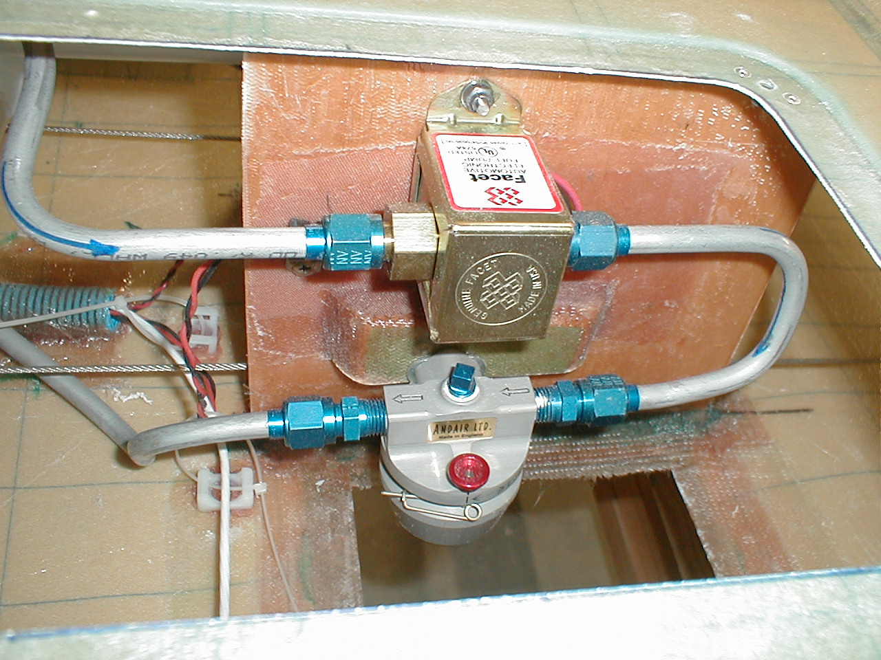

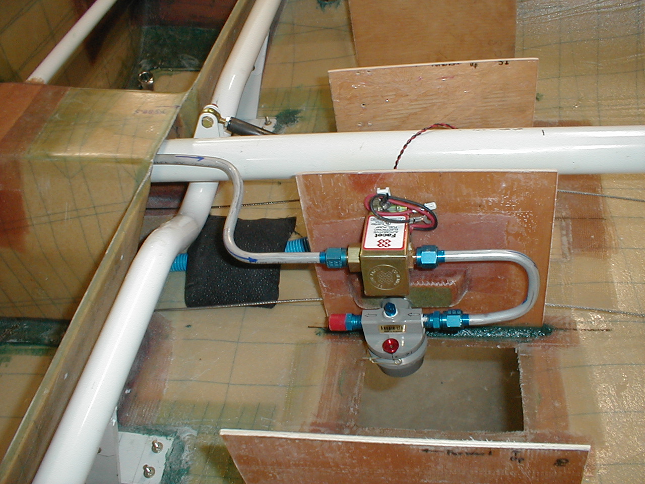

PostPosted: Sun Oct 26, 2008 4:33 pm    Post subject: fuel pump etc Reply with quote
This is what I did.....
A Good00075x1211625659x1200715650/aol?redir=http://www.freecreditreport.com/pm/default.aspx?sc=668072&hmpgID=82&bcd=emailfooter"> See yours in just 2 easy steps!
 Filesize:  376.39 KB
 Viewed:  528 Time(s)
 Filesize:  378.15 KB
 Viewed:  465 Time(s)
Mike - thanks for the nice pictures. The layout looks neat ....
But shouldn't the gascolator be ahead of the fuel pump in the sequence?
And all the advice I've seen is that the pump wants to be mounted at
45 degrees, or at least have its inlet lower than its outlet.

ptag.dev(at)tiscali.co.uk
PostPosted: Mon Nov 03, 2008 1:55 am    Post subject: fuel pump etc Reply with quote
Hi! Rowland
Don't know about "ahead" of fuel pump for gascolator. But IMHO in
direction of flow terms the gascolator needs to be between tank and pump
(Of course in this context "ahead" may be the same). The last thing you
need in the pump is unfiltered fuel.
Bob H G-PTAG
