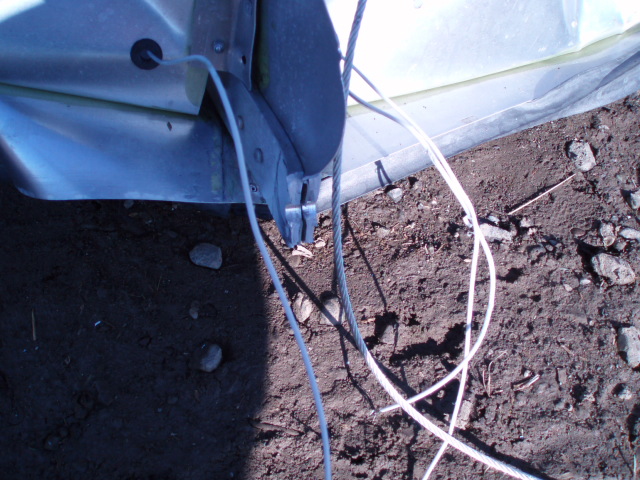

Hello,
have a look on this page: http://www.geocities.com/mgd3/flying/flutter
The damage is like the same on the attached photo from a 601XL accident.
austria
