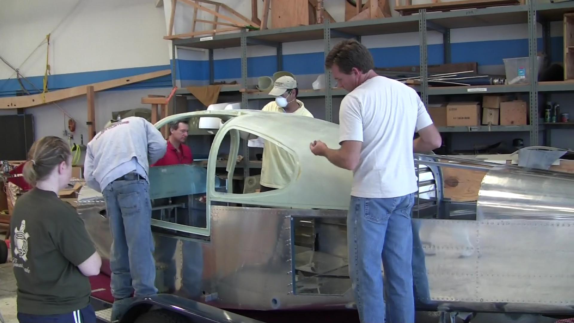

Here's one shot captured off a video of the RV-10 top being installed at
Dave's seminar this past weekend. That was the first of two fits. All that
was needed after this was to grind off some high spots, trim a couple of
other spots and the install was essentially done. It does appear to require
a minimum of two people, although I'm sure many have done it solo.
Dave is in the red shirt. Jeff Carpenter, whose cabin top this is, is to
the right making sure he still has a finger tip left after if got between
the top and the fuselage.
John Jessen

rene(at)felker.com Guest
Posted: Tue Nov 18, 2008 2:59 pm Post subject: Dave Saylor / Aircrafters / Composite Grade School |
It just seems unfair.......I think I put mine on and off 20 times......but
that is what I get for not going to the class and learning from a pro.
Rene' Felker

Posted: Tue Nov 18, 2008 4:04 pm Post subject: Dave Saylor / Aircrafters / Composite Grade School |
I attended the previous class and I think I had it on and off about 15 times
before finally calling it good. Took all of a Saturday and a few followup
hours on Sunday. The smoothing out work is never done you just have to call
it quits eventually and live with it. Anyone who tells you differently is
high on the epoxy fumes so I wouldn't trust them.
-Ben
