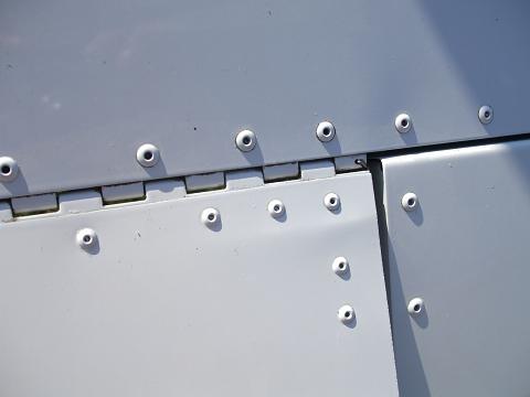

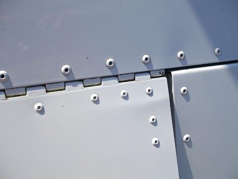

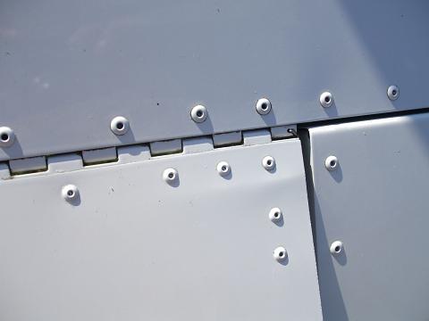

I have a little dent in my LH aileron ruder at the hinge area.
can someone give my advise if i should worry or if this could be caused by "flutter"
thank you
 Filesize:  23.08 KB
 Viewed:  1074 Time(s)

PostPosted: Mon Nov 17, 2008 8:47 am    Post subject: Re: All 601XL grounded in Netherlands Reply with quote
Sabrina,
i send my pics to Michael H. and waiting for answer.
this 601xl is always kept in hangar and has about 70hrs

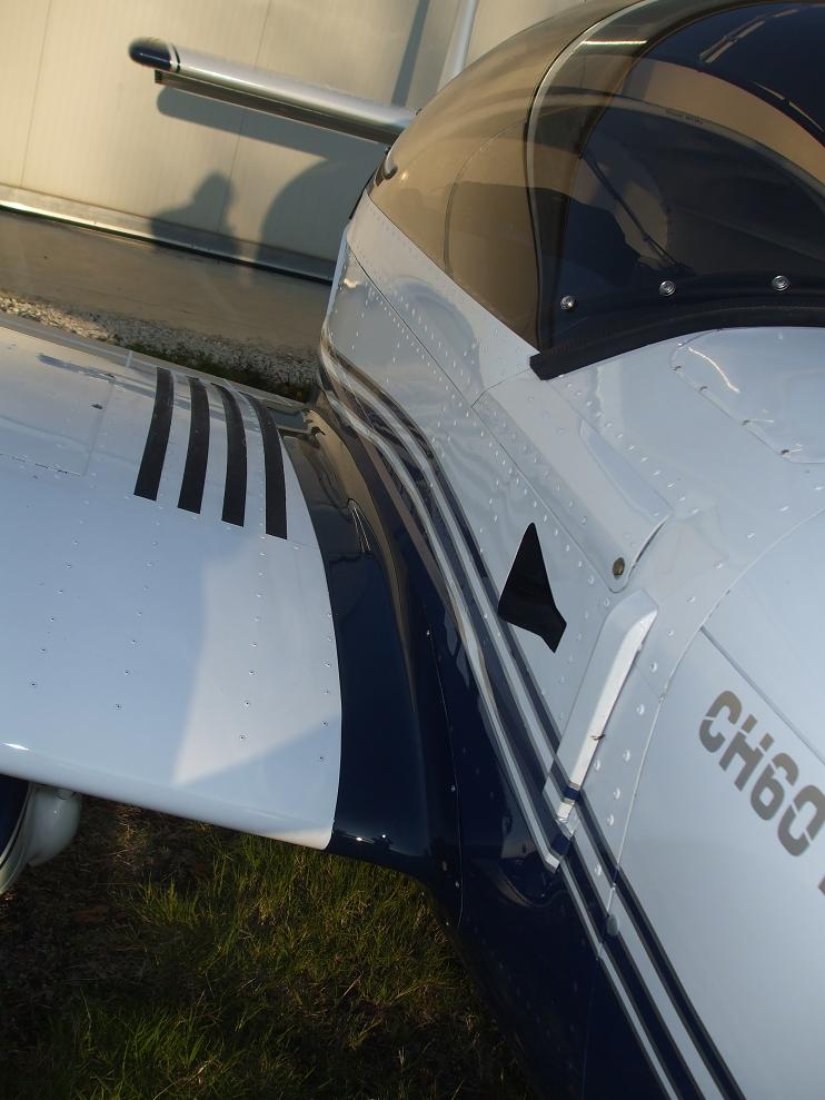

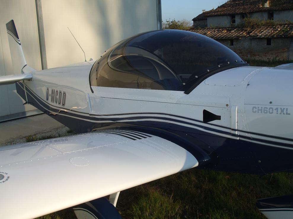

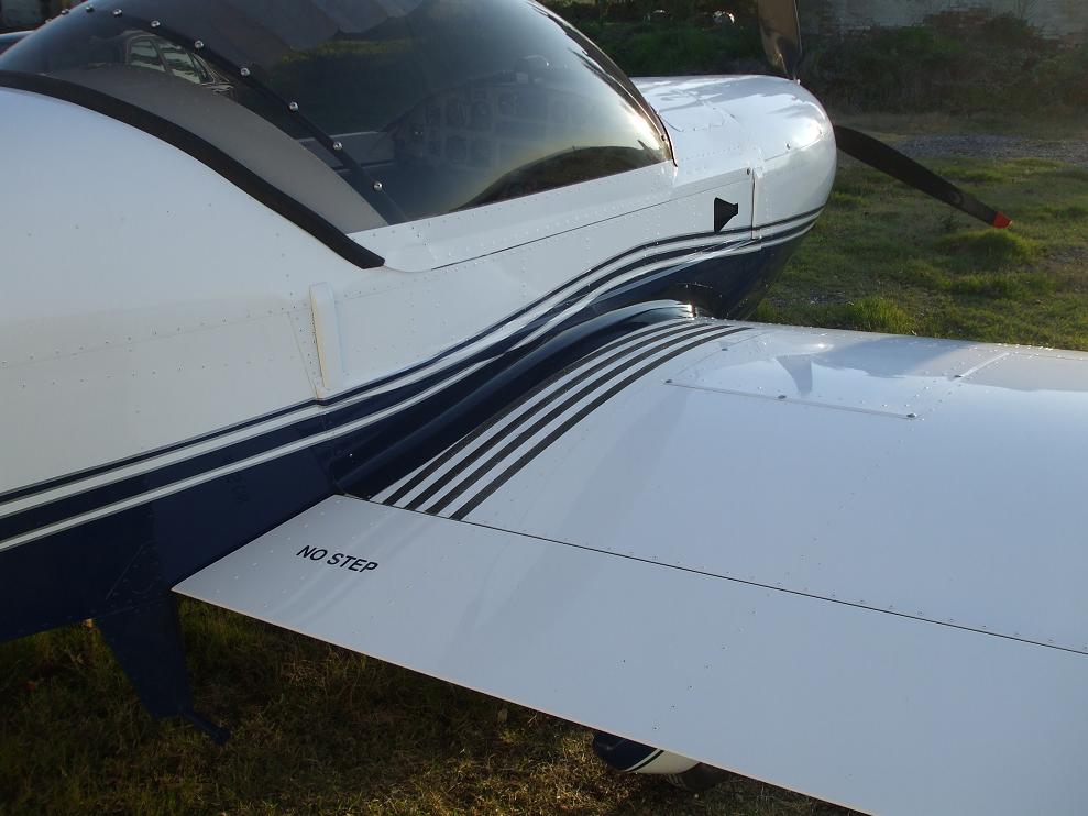

on a other issue i fitted some wing root fairings from Zenair in France looks real cool
 Filesize:  88.71 KB
 Viewed:  1039 Time(s)
 Filesize:  87.13 KB
 Viewed:  1048 Time(s)
 Filesize:  90.73 KB
 Viewed:  933 Time(s)

Terry Phillips
Joined: 11 Jan 2006
Posts: 346
Location: Corvallis, MT
PostPosted: Mon Nov 17, 2008 9:16 am    Post subject: All 601XL grounded in Netherlands Reply with quote

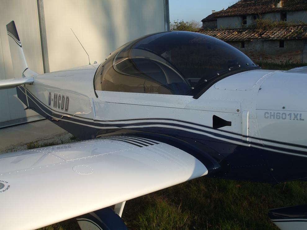

Very good point, Sabrina. and a very interesting photo.
I wasn't aware of Alex's photo. Where did you find it, BTW? My search fails me in trying to locate it. Alex's photo points out a good example of a CZAW "beef up," i.e., the diagonal bracing in the fuselage side panels. I don't recall seeing that in my B-23. I believe that ZAC did copy that feature in the 650. It is probably a good idea and I will probably add it to my 601XL.
Regarding the skin thickness, one must also be aware that CH's designs also change over the years. Fortunately, ZAC has documented these changes on their website. See, e.g.,
http://www.zenithair.com/zodiac/xl/data/xl-update-3rd-ed-1st-rev-4-05.pdf
where you find the following:
6-B-3 04/05 REAR SIDE SKINS
1) new page layout: Moved 6B3-3 and 6B3-4 to drawing 6-B-1 (01/05)
2) 6B3-1 Rev. 2 change material thickness from t=.016” to t=.025” (12/04)
3) 6B3-2 deleted battery access option (area is now accessible through bottom access
panel) (12/04)
4) 6B3-6 Rev 1 new width at front and rear, changed 67 to 61 , 251 to 272mm (03/05)
5) New parts 6B3-7 and 6B3-8 piano hinge and bottom fuselage access panel. (12/04)
6) Re-positioned 6B1-7 between the Z and 6B5-2 (12/04)
note: the aft rivet line through the fairing 6G3-2 is the same rivet line through the piano
hinge and Z angle.(12/04)
7) Deleted Gusset 6B3-5 (01/05)
Cool Add nutplate 21075L3 (02/05)
9) Added A4 pitch 20 bottom skin 6B1-4 into 6B1-1 (02/05)
10) middle diagram: 340mm between rivets for the H.T frames (measured on center line)
(03/05)
11) top right diagram: riveting L angles to side skin 6B3-1 changed pitch from 60 to 40
(04/05)
Where I've colored item 2) to red for emphasis.
So, while I will readily agree with you that CZAW may have changed skin thicknesses, etc., over the years, I'm not yet ready to agree that their kit differs from ZAC except for the "beefing up" and the landing gear already cited. While their changes may (and I emphasize may because I don't have their design history) have lagged ZAC's would not be very suprising, because they would have had to react to whatever ZAC published.
If you can show me examples of "light weight" CZAW designs, materials, etc., that differ from ZAC's designs, I'm ready to admit your point.
Terry
At 07:01 AM 11/17/2008 -0800, you wrote:
"But, they are lighter in only one place: The landing gear... Other than that, CZAW 601XL's are identical or even beefed up a bit compared to the standard Zenair 601XL. I believe" Terry
Terry,
Different CZAW 601XLs have different skin thicknesses, especially the kits as pointed out by Alex. The attached photo is of an EU CZAW kit. The QQ-A-250/11 does not designate a .025 skin, look up at the 0.016 in
6-B-3 08/05 specs .025 on the US version. .025 is 56% more AL than .016, so our rear fuselage skins alone weigh 56% more than the CZAW kit.
The FAA reads this list, we can't keep telling them that the all CZAW 601XL are built "identical" or "beefed up" compared to our aircraft if it is not necessarily true. They may start believing us.

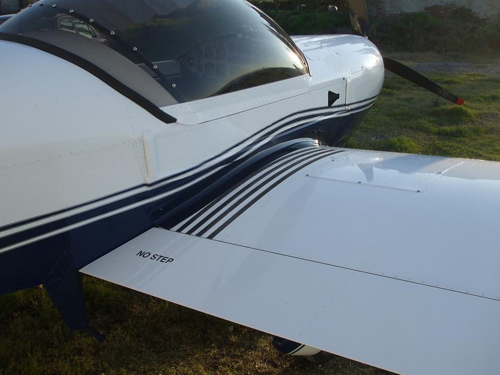

the difference i think the 601xl from CZAW also have is that the angle of attack of the wing is flatter because CZAW only uses Rotax engine and that engine is less heavy and therefor less front heavy and less lift required and also more speed archieved . i been told this by chip erwin on my visit to the czaw factory.
