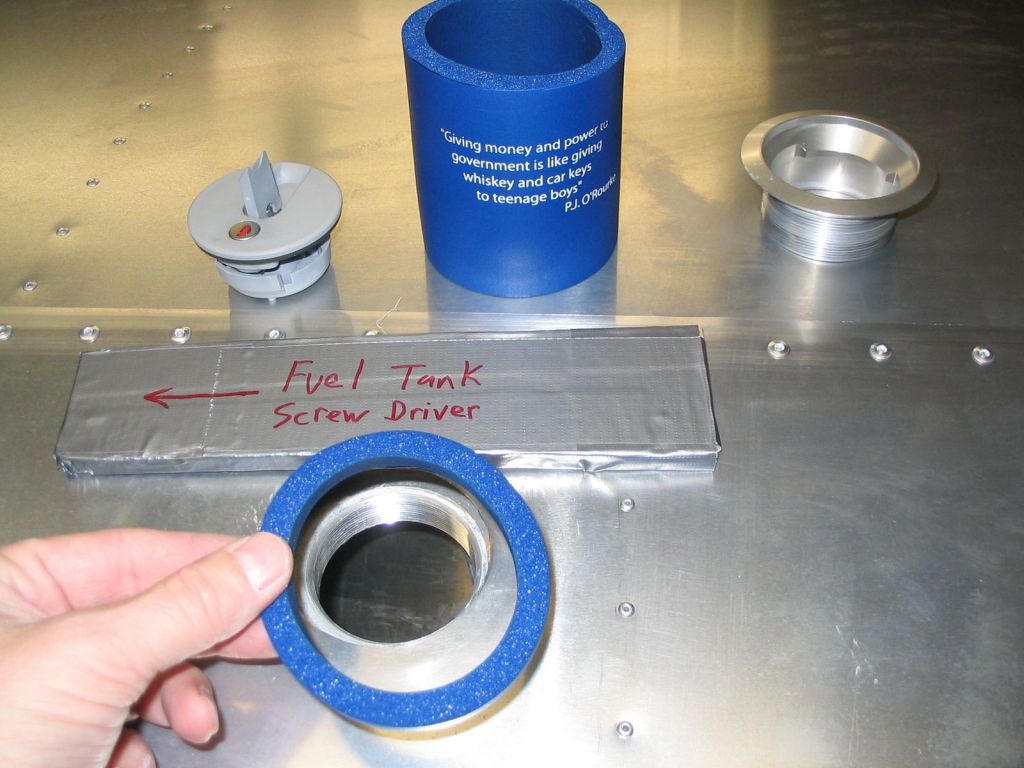

One 601XL builder (Patrick W.) used the foam sleeves you put around a beer
can to support the skin around the neck.
-- Craig

My only question about the beer can insulator is if the foam rubber
disintegrates in contact with fuel.
-- Craig
