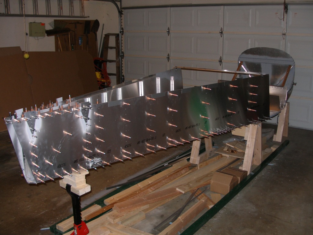

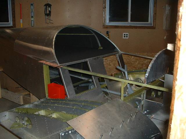

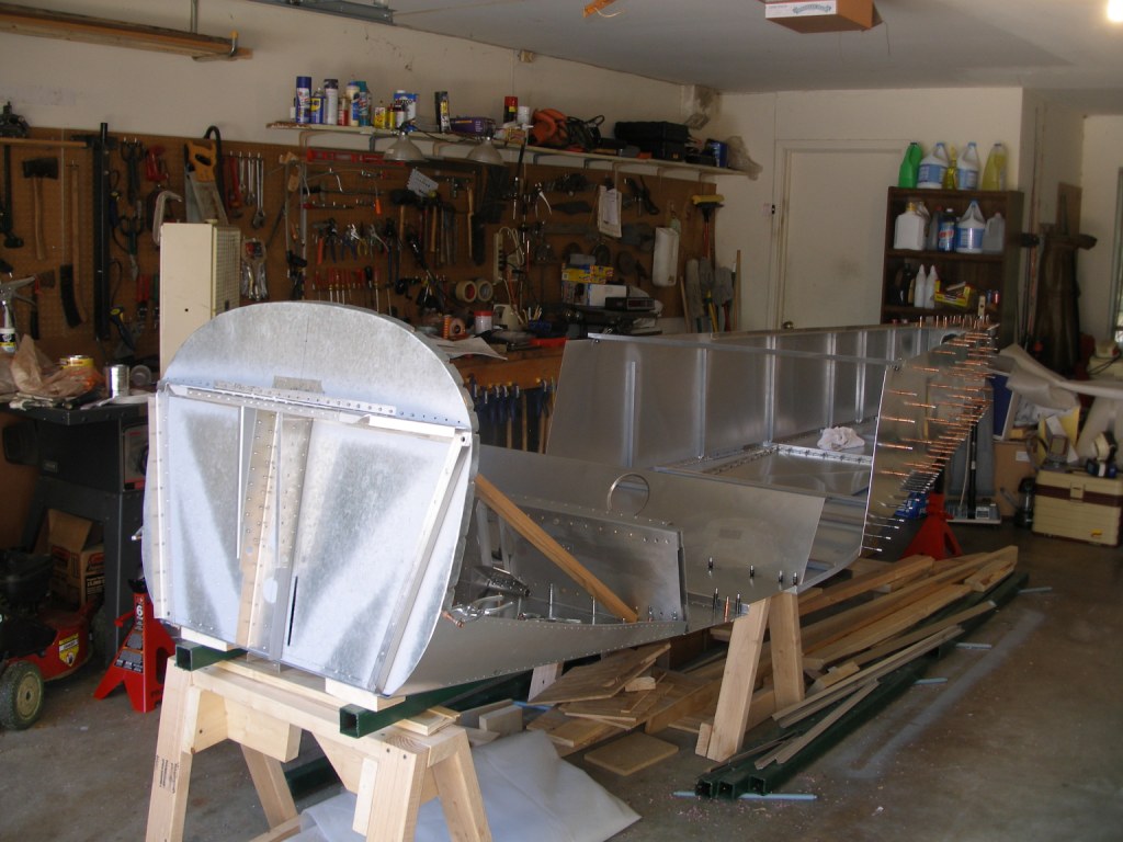

I'm a six footer, but I didn't have any trouble starting and working the fuselage on the same table I built the wings on. When the time comes to take the fuselage off the table, you can lower it quite a bit to make things easier to get to. I've attached a couple of photos showing what my fuselage looked like when it came off the table. You can see, there is not a lot of "high up" stuff on it at this point. Most everything up to this point has been built at table top level, right on the table top.
Jay in Dallas

I moved to the hanger at about the point that Jay's photos show above. and like Jay I came off the table at that point.

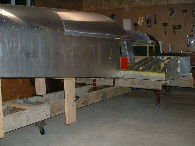

PostPosted: Thu Nov 27, 2008 4:28 pm    Post subject: Working table height Reply with quote
Pavel-
I spent a weekend and $50 (Recycled discarded wood) to build Larry Mac's
fuse fixture. I've never, ever, ever regretted the decision. Other builders
have said, "I can't wait to get on the gear, but what do you care, you've
been on wheels since day one!"
In the pictures, I moved my project from side to nearly head on in 2
seconds using the force my 3 year old grandson can exert. Can't let him do
it- he'd put it through the wall!! Don't have enough room in the shop to go
totally head on.
Better pictures that will give you an idea of how to assemble it are
available on Larry's site. There are no plans, but that isn't really a
problem. I'm sure both Larry and I will help all we can.
Bill

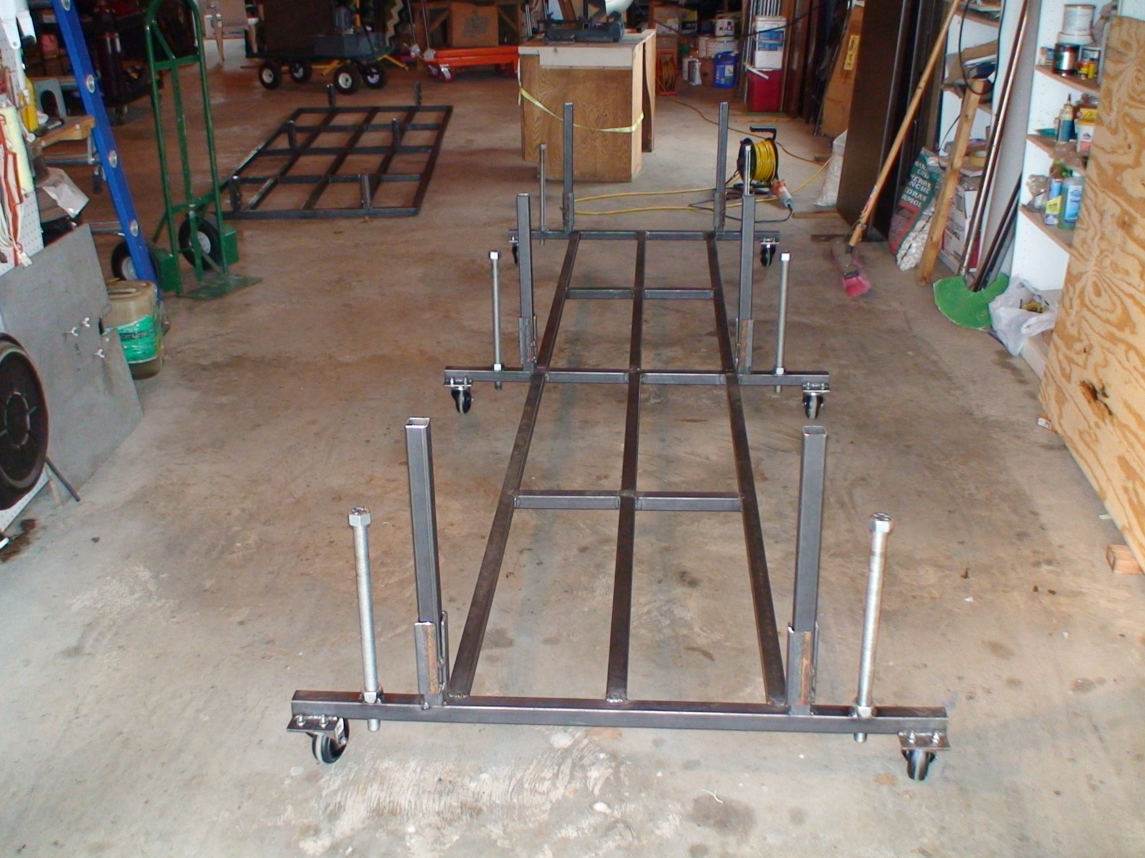

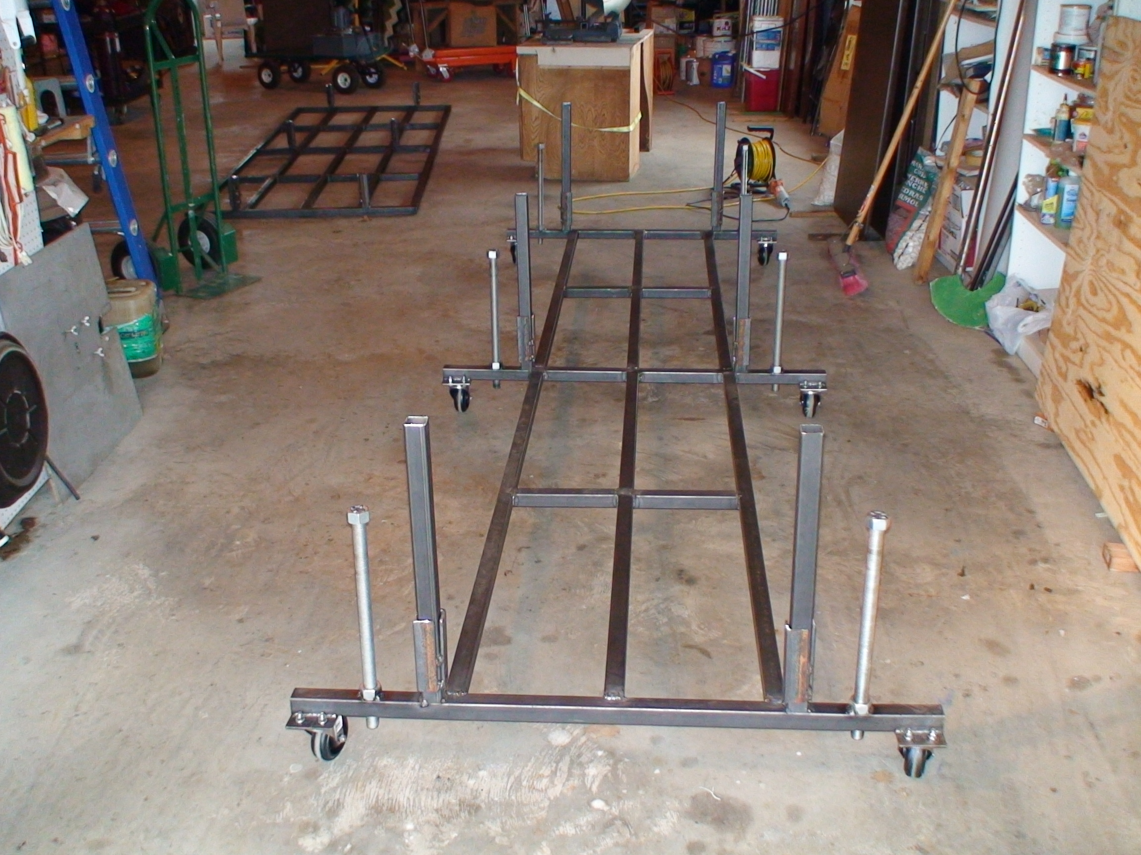

PostPosted: Tue Dec 02, 2008 8:27 pm    Post subject: Re: Working table height Reply with quote

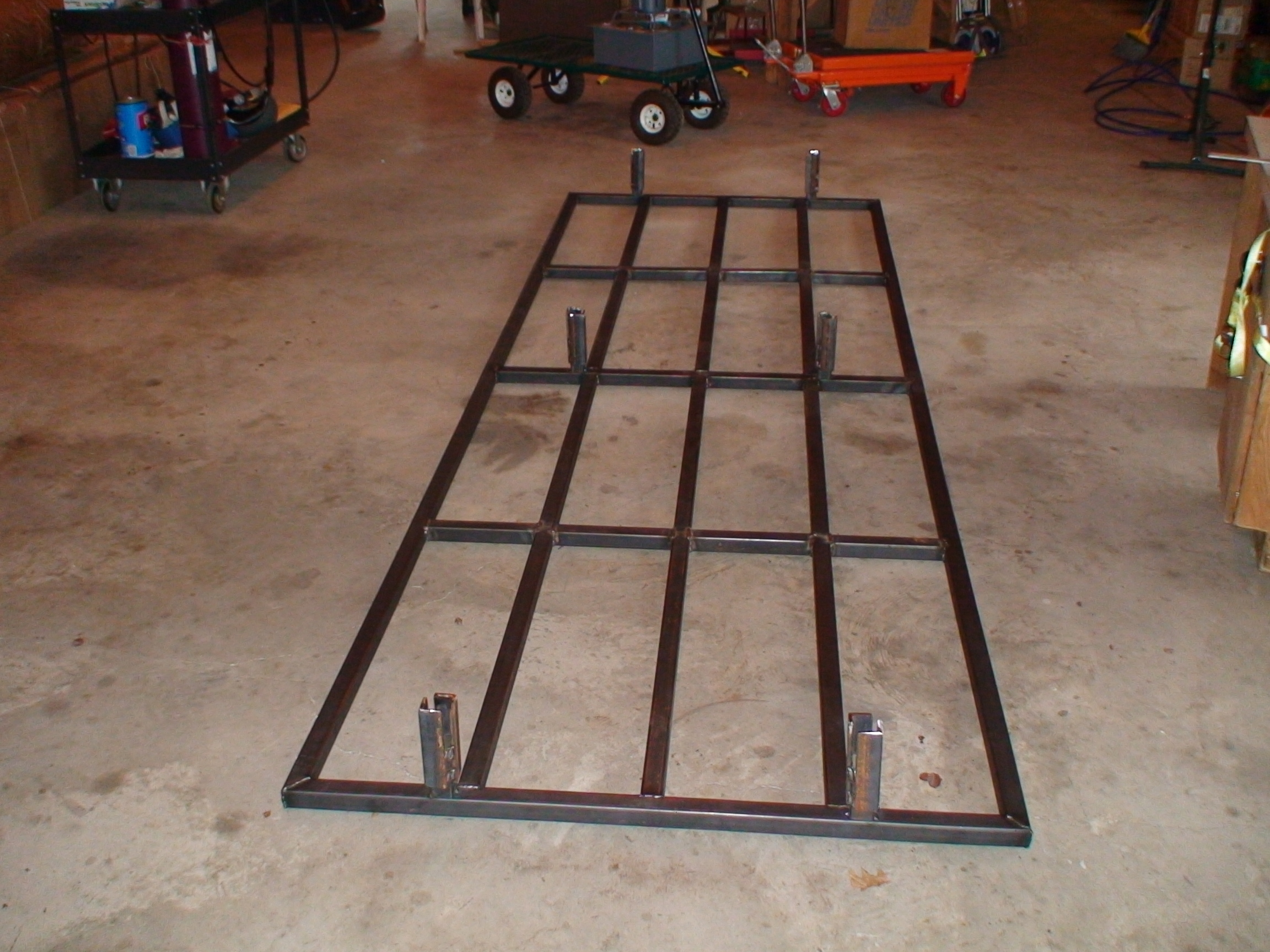

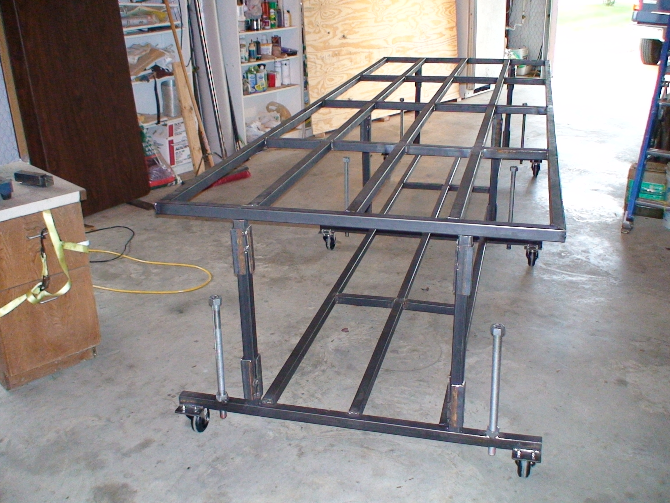

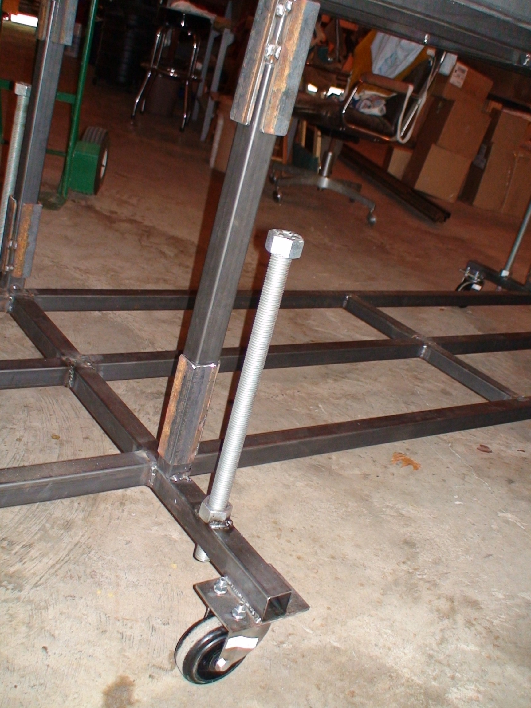

I built my build table with replaceable vertical posts. Both the base and the top have sockets that will accept any length square tube I want. The plan is to put in shorter verticals when I get to the fuselage so I don't have to work at an uncomfortable height. I built mine out of steel but the same concept can be executed in wood. Note the jack screws that take the table off of it's wheels. Not only can I fine tune the height but I can level the table top with then as well. I use an air operated impact wrench to turn a socket which fits the nuts welded to the top of the all thread.
The finished table was primed, painted and topped with 3/4 plywood and a replaceable Masonite skin.
Some pictures are attached.
Hope that helps.

A closer look at the socket system and jack screws.
 Filesize:  711.79 KB
 Viewed:  944 Time(s)
Here is the assembled top and base
 Filesize:  1.47 MB
 Viewed:  993 Time(s)

This is the base of the table
 Filesize:  1.45 MB
 Viewed:  948 Time(s)
