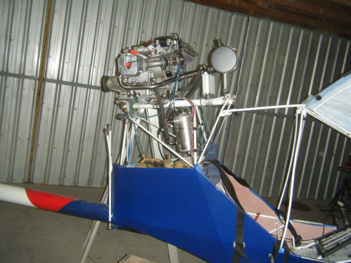

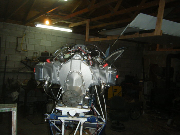

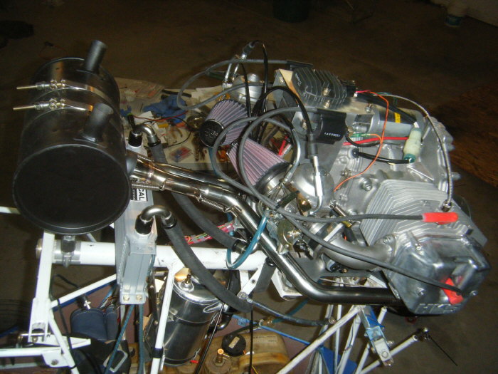

Guys, and Cristal,
I have completed the installation of a HKS 700 E to my Firestar II. Well actually I still have to hook up the tach and install two switches for the mags and add oil before I can fire it up. I am also waiting on a quick connect oil drain valve to put on the bottom of the oil tank. It should be here in a few days.
[img]cid:F08CF2F947A64692824ACDBC515F7378(at)larryPC[/img] [img]cid:5A99F2133B9E4A6998E7E1D7CF0B0F1E(at)larryPC[/img]
[img]cid:D2432AB1426C440398D6F640E2F8C8F3(at)larryPC[/img]
As you can see there are a pile of wires and stuff all over the top of the engine, but at least every thing is contained on top of the engine. I made these pictures small for the band width challenged. If any one would like more detailed ( larger size let me know and I will send them back channel)
I purchased the engine from Jerry Olenik of Green Sky Adventures in Hawthorne Fl. I cannot stress enough how well he has treated me. I am not by nature and inclination to be mechanically inclined. In fact if I get grease on my hands I count the whole day as a failure. He took the time to answer any and all of my questions to guide me through a very traumatic experience. Smile Jerry has all the parts and modifications needed to mount one of these engines on a Kolb as well as worked out all the quirks and little things that you need for the installation. If any of you decide to go four stroke, you could not do better than Green Sky. I do think that there should be a "HKS for Dummies" manual since both Jerry and HKS only hit the high spots and leave some of the other stuff unexplained. However Jerry never complained when I called for an explanation of where this or that goes.
The great flying weather has of course departed for regions a lot further south. ( Yes Beauford, my heart bleeds for you, imagine having to endure 65 degree weather, how terrible) Perhaps it will get warm enough to get a few tests in to see the difference between this one and a 503. I of course will have to do a weight and balance first, but I hope to have it in the air soon.
Larry C

grantr
Joined: 12 Sep 2007
Posts: 217
PostPosted: Mon Dec 08, 2008 7:39 pm    Post subject: Re: HKS 700 E Reply with quote
Larry,
Did you trade in a used engine for the HKS engine or is this a new plane?
It looks nice!
I would like a 4 cycle at some point.

PostPosted: Tue Dec 09, 2008 12:57 am    Post subject: Re: HKS 700 E Reply with quote
Larry,
If you want to send me the high res pictures I'll be happy to make them available to all on my site. Just forward them to icrashrc(at)aol.com and i'll post a link for all.
Scott
