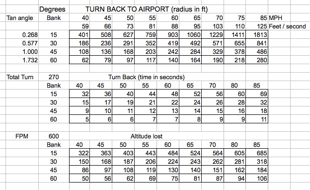

The time to turn an airplane depends primarily on the bank angle of the turn and the airspeed being flown. It is a mathematical relationship that is a function of the tangent of the angle of bank. Attached is an image of a spreadsheet table I put together to show this relationship at various airspeeds and bank angles. The first table shows the turn radius (not diameter) in feet for a given bank angle and airspeed.
The second table uses this data to derive the time in seconds to make a turn of 270 degrees. I used 270 degrees because to get back to the runway you have to turn 180 to get the right heading but then you are two radii away from the runway so then you have to keep turning, say another 45 degrees then turn back 45 degrees to get re-aligned with the runway, for a total of 270 degrees of turning.
The third table takes the second tables data and ASSUMING a 600 FPM descent rate, calculates the loss of altitude in the 270 degree turn.
NOTE: This is not a recommendation for or against turning back to the runway at any time. It is simply showing the mathematical relationship amongst bank angle, true airspeed, time to turn and altitude lost in doing so.

Thom Riddle
Joined: 10 Jan 2006 Posts: 1597 Location: Buffalo, NY, USA (9G0)
Posted: Tue Dec 09, 2008 6:07 am Post subject: Re: What is your Altitude loss in a 180 degree turn? |
I did not use very steep bank angles in the previous table posted so I am posting another with steeper bank angles, for your amusement and perhaps amazement.

Joined: 09 Jan 2006 Posts: 4639 Location: Titus, Alabama (hauck's holler)
Posted: Tue Dec 09, 2008 6:25 am Post subject: What is your Altitude loss in a 180 degree turn? |
| Quote: | I did not use very steep bank angles in the previous table posted so I am
amazement.
Thom:
Are these Kolb numbers, or a generalization?
I'm not surprised at the results of steep bank angles and higher airspeeds.
I believe I mentioned in a previous email, agressive turns take less time
and use less altitude. The problem with that maneuver is attaining and
maintaining the increased airspeed at low altitudes, and how hard can I
crank it around, at very low altitudes, without stalling.
If I get a chance to fly today, I will practice some of this stuff at
altitude to see how it works out.
_________________ John Hauck
Titus, Alabama |

Thom Riddle
Posted: Tue Dec 09, 2008 6:43 am Post subject: Re: What is your Altitude loss in a 180 degree turn? |
John H,
The first two tables are mathematical relationships that are independent of the airplane being flown. This means that the turn radius and time to turn are the same for any airplane at these bank angle and airspeed combinations. Ever notice how big a radius it takes to turn a jet fighter flying at high speed? It takes many miles to turn around at high speed, even in a near 90 degree bank angle. Ever wonder why gyroplanes (and helicopters for that mater) can turn on a dime? Because of their very low speed capability. At higher speeds they cannot turn so quickly or in such short distances. It is pure math.
The third table, ASSUMES a 600 FPM descent rate. This table depends upon that assumption. If your airplane descends at a different rate then the altitude loss numbers will differ linearly. In other words if your airplane descends at say 450 FPM then the altitude loss will be 3/4 of those in the table shown for a 600 FPM descent rate.

On 9, Dec 2008, at 9:24 AM, John Hauck wrote:
| Quote: |
> Thom Riddle
Thom:
airspeeds. I believe I mentioned in a previous email, agressive
turns take less time and use less altitude. The problem with that
maneuver is attaining and maintaining the increased airspeed at low
altitudes, and how hard can I crank it around, at very low
at altitude to see how it works out.
| Back to top |

Thom Riddle
Posted: Tue Dec 09, 2008 7:26 am Post subject: Re: What is your Altitude loss in a 180 degree turn? |
John H,
You bring up a good point. The tables I posted assume 1 G flight because the original question was about turning back with engine out. In a descending turn without power or attempt to hold altitude it is easy enough to maintain 1 G or less.
What gets a lot of airplane pilots in trouble is pulling back on the stick during a power out descending turn in the vain hope that some magic will be performed. The vast majority of CFIs and the FAA pubs teach that Gs increase in high banked turns. Of course this is true if you are maintaining altitude. In a power out situation any attempt to maintain altitude in an airplane will eventually result in exceeding the critical angle of attack and a stall. The trick to quick descending power out turns in an airplane is maintaining 1 G or less loading. If this is done you can get turned around pretty quickly at slow speeds. Load it up with back stick and you are asking for a stall/spin fatality.
_________________ Thom Riddle
