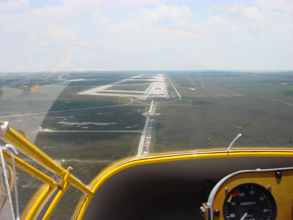

If you are high enough, it is far better to do a 180 degree back to the runway than needlessly glide straight ahead into trees and powerlines. A friend of mine flying a Rans at our airport had a total and sudden engine failure over the end of the runway over the summer, and successfully turned 180 degrees and landed back on the runway instead of going into houses and trees. GrantR has the right idea on this one, if you have a long enough runway like he does, with really bad options straight ahead and to the sides, a 180 degree turn back to a safe landing would be the smartest and safest thing to do. Of course this requires practice and extra skill, but from Grants practicing this, I am sure he is up to the challenge if it ever happens. It is important to practice and be proficient with this maneuver if that is part of your engine out plan.
Every situation is different, if the runway is short an you try a turn back to the runway, you will kill yourself. If you do not have enough altitude and attempt this, you will kill yourself. If the pilot has never practiced this maneuver, he will again most likely kill himself. Like most situations in aviation, you must use good judgment depending on the airport, considering: runway length, and obstacles ahead and to the sides, and YOUR SKILL LEVEL. 270 degrees of turn is not needed to make a turn back to the airport, my friend in the Rans turned about 200 degrees total, a very tight 200 with put him a bit off centerline but angling back to the runway, which resulted in landing in a slight angle across our wide runway which he straightened out once rolling on the ground. My friend is a good pilot, and flew his return perfectly, with no damage to the plane or himself. There were no good landing options straight ahead or to the sides as in Grants case.
The problem is that we only hear about the cases of returns to airports that went horribly wrong, but almost never hear about successful returns back to the field. It is far easier to " Parrot " the popular statement of NEVER attempt a return to the field than it is to analyze the facts, and acquire the skills to make the correct choice depending on the situation. The attached picture below shows a 10,500 foot runway with nothing but trees at the end and to the sides, only a total idiot would glide straight ahead for miles into trees rather than turn back to this airport in the case of an engine failure over the end of the runway. EVERY SITUATION IS DIFFERENT, there are no hard and fast rules here.
Mike

JetPilot
Joined: 10 Jan 2006 Posts: 1246
Posted: Tue Dec 30, 2008 10:19 am Post subject: Re: What is your Altitude loss in a 180 degree turn? |
| John Hauck wrote: |
10,500 feet is a lot longer than my 750 feet. I think I could handle it.
mkIII |
After seeing your landing video in Louisiana, I think you could pull it off, just be careful not to blank out your elevator on the flare !
And your " Air Taxi " technique would be very useful at this field
Mike
_________________ "NO FEAR" - If you have no fear you did not go as fast as you could have !!!
Kolb MK-III Xtra, 912-S |
| Back to top |
