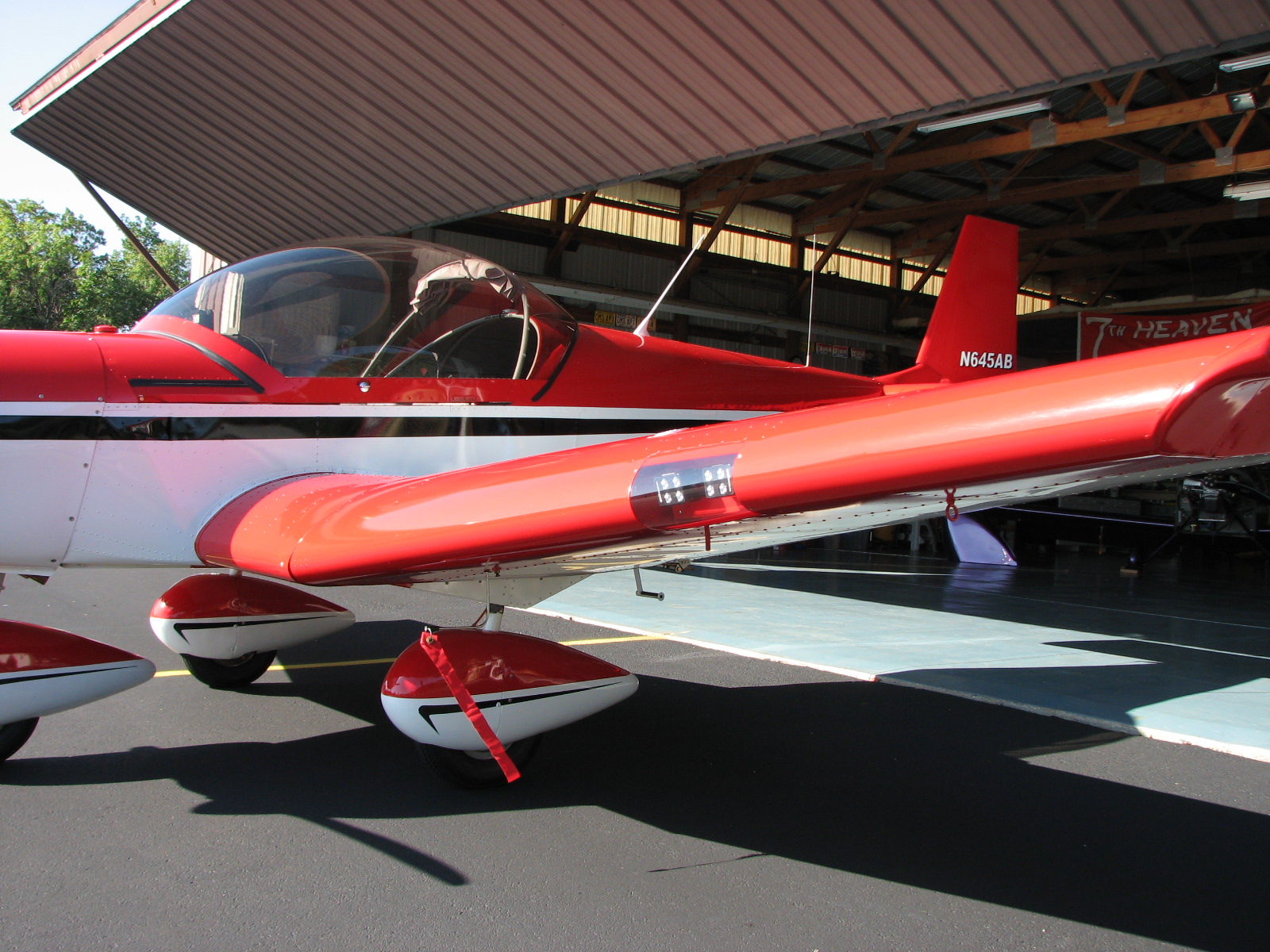

agbeyer(at)sbcglobal.net Guest
Posted: Thu Dec 18, 2008 9:07 am Post subject: Strobe control unit mounting locations. |
Hi guys,
I have been using The Aeroflash Nav/Strobe system on my 601 HDS for a little over four years. The control boxes are mounted between the center wing section and the outer wings. I had a landing light and a taxi light mounted in the left wing for almost that same amount of time. I do a lot of night flying and because of the high draw of the two GE 4509 bulbs and the Nav/Strobe lights I had to watch the amount of time I had these lights turned on during long taxis or low RPM times. The Jabiru alternator is a 1:1 ratio and does not charge, or charges very little, until you have higher RPM. It is not like an external alternator with a 2:5 or 3:1 overdrive ratio like your car or most marine engines.
Like Rick said "This sounds like a commercial", but it's not. While at the show in Oshkosh I was looking at all the different light set-ups. I bought two LED lights (4 LED's per), one for landing and one for taxi. (SEE PICS Attached) I did not buy the one with 8 LED's because I have to set them at two different angles. Because of the hight nose angle of the HDS during landing I set one with a slight down angle and the other level to the ground for taxi. With the old set-up I would use one light at a time, but with the new LED's they are both on at once. The old lights would draw about 8 Amps. each and the new ones draw 9 tenths of an Amp. With both on at the same time they are brighter than one of the 4509's. The beam of light is much wider than the old ones so even the taxi light set level works as a landing light. I did not run any more wires to control the new lights. The switch I used for my taxi light is now used to control both lights in their Wig/Wag mode. The company I bought from is called AeroLEDs http://www.aeroleds.com/. "What a difference in current draw".
While at the AeroLED both I also looked at their new AERO-PULSAR Nav/Strobe/Pos wing tip lights that they were still developing and they said that they should be out by the end of this year. They had a show special -- If you paid $200 down they would knock off $150 from the list price, and if you didn't like them when you got them you would get your money back. Because these are also LED's they will draw a lot less Amps compaired to the Aeroflash lights I am now using. With the new lights I will not need my tail light, but they said they are working on an LED tail/strobe light that will fit my mount. I will be installing a new tail light when they are available (The more strobes the better).
Happy LED user,
Al from Oshkosh
