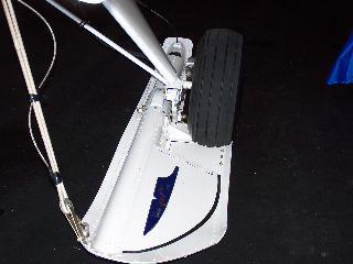

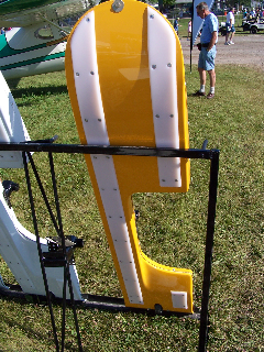

Here's a shot of Wipaire's Air Glide ski that I saw at Oshkosh this
year. I'm following the basic shape of these, in designing my non-
repositionable skis. The lower picture is of Trickair ski. I though
that I would pattern mine with the wider front area, and with no rear
ski area directly behind the wheel...sort of like a cross between the
two types shown....like the Wipaire in footprint, but the other in
being a fiberglass-covered tubing frame, like I have built before. If
these pics don't come out in the order that I've placed then, the
Wipaire has its name on it, the Trickair is yellow, and the other two
pics are my skis...the one shot on snow is at Oshkosh. You can see
how far my present skis ride above the snow, creating lots of drag.
The next set will be MUCH lower to the ground.

Lynn C Are you going to have keels on the bottom similar to the yellow ski? Also C I can't see from the picture C how do the skis attach to the axle? Do they screw to both ends C or just the inboard end of the axle? The white one doesn't seem to have any mount for the outboard end of the axle.
Pat Reilly

Those "keels", although they act like keels are actually wear bars,
that take the brunt of the wear that would otherwise occur if the
tire should get low, or if you land hard on pavement. Yes, I'm going
to have them on mine. Before I make the plywood and fiberglass
bottoms, I'm going to use UHMW over the whole bottom, and then attach
the wear bars to them. I haven't thought it completely through yet,
but I might sandwich my "spray rails" between the bottom and the wear
bars.

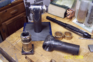

I'll post a picture or two of my pedestal mount, as far along as it
is, in a little while.
The yellow skis (Trickair) attach to a stub axle that is bolted to
the inboard side of the Grove landing gear. The white one...the
Wipaire...attaches to the landing gear by (I think) either bolted on,
or welded on, brackets. Go to http://www.trickair.com/ to see
their site and maybe watch the video of their skis in action. I
haven't watched it, because my computer modem is too slow. Also, look
again at the picture of the yellow ski. Just to the left of the ski,
is the tubing framework that the ski is built around. It is black and
hard to pick out because it blends in with the display rack, which is
also black.

On Dec 21, 2008, at 1:22 PM, patrick reilly wrote:
| Quote: | Lynn, Are you going to have keels on the bottom similar to the
yellow ski? Also, I can't see from the picture, how do the skis
attach to the axle? Do they screw to both ends, or just the inboard
Pat Reilly
Mod 3 582 Rebuild
Rockford, IL
_________________ Lynn
Kitfox IV-Jabiru 2200
N369LM |

Pat-
Here are the pictures of the pedestal parts that I've built so far,
and a mockup of the proposed ski using 3/4" wood where 4130 round
tubing and flat plate will be. As you can see, the 4 holes in the
"stub axle" will bolt up to the back side of the Grove gear. If I
choose to leave this stub axle in place all year long...with suitable
fairing made of fiberglass....installation will be simply sliding the
ski onto the axle and securing the nut and cotter pin, and attaching
all the safety cables, etc., ...and praying for snow.

Kirk , they look very interesting .May I request a couple of close up pictures .
DeWayne at kitfox(at)bresnan.net (kitfox(at)bresnan.net)
| Back to top |
Lynn Matteson
Joined: 10 Jan 2006 Posts: 2778 Location: Grass Lake, Michigan
Posted: Tue Dec 23, 2008 9:46 am Post subject: skis |
Looks like 4 wheels total, and about 1152 sq. in. total of surface
area. Looks like the tail end is flat...any problem dragging it
backwards in snow? The bottom looks to be more than 1/4" thick...is it?
Good looking skis, Kirk.
Lynn Matteson
Jabiru 2200, #2062, 596+ hrs
Sensenich 62x46
flying again after rebuild, and new Electroair direct-fire ignition
system;
also building a new pair of snow skis
On Dec 23, 2008, at 9:33 AM, Kitfoxkirk wrote:
| Quote: | Hello,
I designed and built these aluminum skis (see attached photos) with
small 6" plastic-rubber castor wheels attached. They are 12" wide
and 48" long. I can land on snow or pavement, and they do very well
in 12" powder. The castors are semi hard rubber (I think they are
75 Durometer) and they only stick through the ski about 1". So, the
profile drag in the powder is almost non-existent.
I can take more pictures if anyone is interested in this design.
Just my 2 cents.
Kirk
N369LM |

I will try to get some detailed pictures this weekend and send them out.
Kirk

Great looking skis, Kirk and good craftsmanship! Am I interpreting this correctly that the entire ski rides on the little wheel in the center? How does it do on a grass strip? Is that 1/2 plastic (UHMW) and where did you find it? Ever thought of marketing them?
I'm impressed.
Deke Morisse
Mikado Michigan
S5/Subaru/CAP 402+ TT
- Joseph Joubert
| Back to top |
aviateer
Joined: 08 Aug 2008 Posts: 23
Posted: Tue Dec 23, 2008 7:46 pm Post subject: skis |
There are two wheels in tandem like a roller blade. I wanted only two wheels, otherwise one would not be able to turn the plane on pavement. Since these pictures I posted (taken in 2004), I purchased better wheels. The wheels I now have are 6" in diameter, and 2" wide. They are rounded so the profile is very small. As I stated earlier, the skis do very well in powder snow. I was at a grass strip with about 12" to 18" of tight powder snow, and the skis worked very well. I was off the ground in the same time as I would be on packed snow. When I shut down, I dug down into the snow to check how deep I sank and found that I went down about half the depth of snow (about 6" to 8" down). My prop was still well out of the snow. I made the skis a little tall because I wanted to keep the prop out of the snow as much as possible.
The wheels in the ski were designed for pavement use. That is why I wanted a non-pneumatic wheel. I did not want to have any suspension to give and allow the ski to plant on a hard landing to pavement. This would cause the skis to grab the pavement and flip the plane over on its top. Not a good time! The idea was to have only 1" of wheel penetrating the ski. This would provide a very small profile in powder snow. In packed snow, the wheels act like a skeg to a degree. They almost give me directional authority while taxiing on hard packed snow.
I do not believe the wheels would do very good on soft grass. As I stated, the profile is very small, and that was to allow landings on snow or pavement without any device to move the wheels up or down. I think in soft grass the wheels would sink in and you would be ski on sod. Even the UHMW polyethylene does not do so well on dry grass.
I made the ski bottoms out of UHMW polyethylene that I purchased from Minnesota plastics about 10 years ago. I don't know if they are still in business, but a google search would turn up some supplier I'm sure. The bottoms were suppose to be .250", but I think these are closer to .500".
The skis are a little heavy at about 19lbs each. But, they have been tested. I slammed my Classic IV into the paved runway pretty hard, not by choice, but by poor execution of a landing on a windy day. When I conducted a post flight inspection, there were no cracks or bends of any kind. When I designed the frame of the ski, I placed it in my 20 ton press and cranked on it with a 400 lb scale under it. I reached the 400 lbs on the scale and went a little more. There was no bending or deformation. The wheels are rated at 650lb static, and I think several thousand pound point load for one or two seconds. I have four wheels, so there is no overload there.
As I stated earlier, I will get some more photos on line in a few days.
Kirk
On Tue, Dec 23, 2008 at 2:54 PM, fox5flyer <fox5flyer(at)idealwifi.net (fox5flyer(at)idealwifi.net)> wrote:
[quote] Great looking skis, Kirk and good craftsmanship! Am I interpreting this correctly that the entire ski rides on the little wheel in the center? How does it do on a grass strip? Is that 1/2 plastic (UHMW) and where did you find it? Ever thought of marketing them?
I'm impressed.

Michel
Joined: 10 Jan 2006 Posts: 966 Location: Norway
Posted: Fri Dec 26, 2008 1:03 am Post subject: Skis |
On Dec 25, 2008, at 11:53 AM, akflyer wrote:
| Quote: | The ski bottoms are NOT stepped, they are flat.
As far as I understand, the step on a seaplane pontoon is there to ventilate the water aft of it and give less drag. I agree, it doesn't make very much sense in the snow.
Cheers,
Michel Verheughe
Norway
Kitfox 3 - Jabiru 2200 ... flying as PAX
_________________ Kitfox 3 - Jabiru 2200 |
