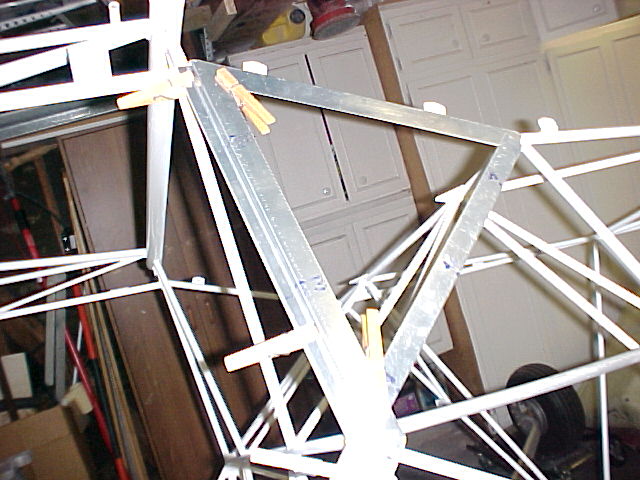

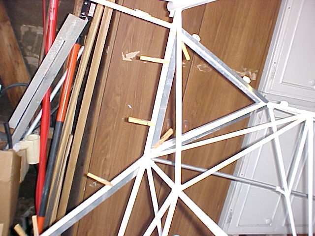

Can someone post a photo of how the side stringers are done at the forward end by the doors. In the drawings first it looks like they are tucked in between the frame tubes, then it appears they just bond to the door frame and are outside the fuselage tubes. I'm really confused. Sometimes what seems simple takes the longest.

Jorge, Pictures are not super but hopefully give you the idea I cut them to fit up in between the tube and stuck up against the inner side of the door frame. You will want to bend the door frame to have a smooth rounded transition to stringer. I drilled a small hole for a small rivet through the frame and into stringer then epoxied and riveted. Make sure door frame corners are bent smooth as it transition to the fabric all around.
George
