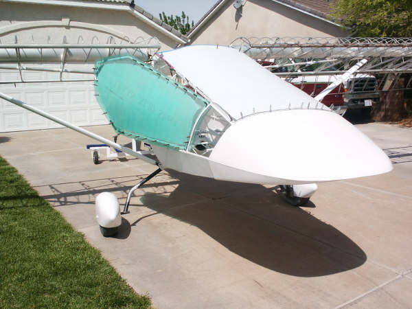

I've seen the tips changed & the Leading Edge spliced, but
not the spar. At least not the inboard end.

As you are aware, I HAVE extended my wing spars, to accomodate droop tips. I chose to extend the outer tip of the spar by using a chrome moly truss and various alum. tubes for triangulation bracing. This method has provided a very strong 22" extension. Scott (icrashrc) used a similar method to extend the end of his spar, to also add droop tips.
Although I think is "possible" to extend the spar at the root (as you descibed), I wouldn't consider it without destructive testing and some engineering calcs. If the splice were to fail at the root, the results would be predictable...bad!!
Yes, as stated, the loads on the inner portion of the spar are in compression. Plus, the spar is also in a bending stress, which would create a shear on an inner extension. It is my opinion that if you add any length to the spar, it should be at the tip.
With regard to failure of my spar extension truss design, I doubt it!! Once it was bolted on, and reinforced, it feels rock solid. To calculate the G forces at 6 G's on just the 22" wide extension is an easy affair. A quick calculation says each extension should be able to support
around 225 lbs, for a 6 G force. 225 lbs wouldn't even get it's attention!!
I think the general concensus here is to add on to the tip. It is reasonably easy, and can provide for a strong platform for droop tips. IMHO!!
