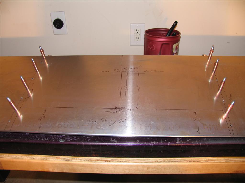

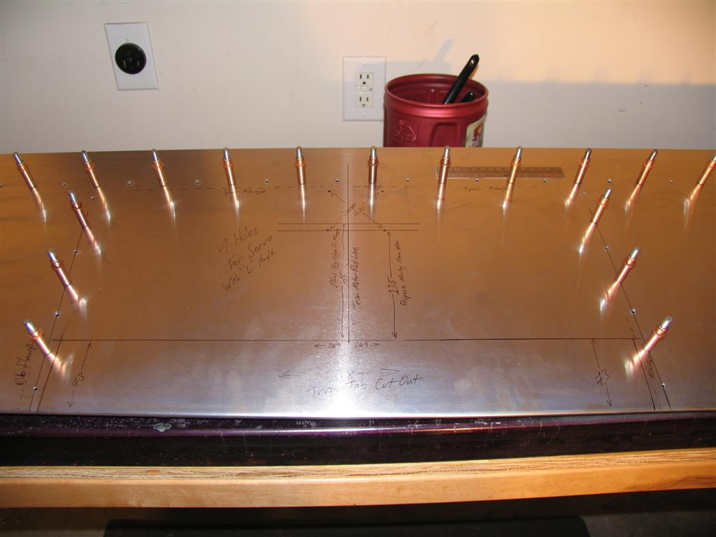

See these attached photos of the top and bottom aileron skin measurements for the trim tab and motor.
The plans call for 145mm from edge of trim tab cut out to the bottom row of holes in the servo, by my measurements 135mm is the better measurement due to interference with the aileron spar flange. Any others out there experiencing the same issue? I love pre-punched skins just wish they'd pre-punched out the trim tab like they do in the elevator.
higher resolution photos available here;
http://picasaweb.google.com/nosky2high/WingKitFlapsAilerons?feat=directlink
if the attached downsized photos don't explain the situation well enough.
phone call to ZAC tomorrow.
Anthony

Ron Lendon
Posts: 685
Location: Clinton Twp., MI
PostPosted: Sun Jan 04, 2009 4:20 pm    Post subject: Re: Aileron Trim Tab Lessons Learned Request Reply with quote
Anthony,
Try transferring the flange line to the outside of the skin after you have the access hole cut. I think the servo needs to be close but not touching the flange, perhaps .5mm clearance.
Make sure you have a straight line from the servo to the trim tab horn and it will work out.
The wings aren't here otherwise I would give you some dimensions.

PostPosted: Mon Jan 05, 2009 8:42 am    Post subject: Aileron Trim Tab Lessons Learned Request Reply with quote
I had the same experience. It appears that the plans are incorrect. When I
first asked ZAC about it, they suggested overlapping the spar flange with
the servo, which I didn't think was a good idea, so I asked if I could move
the servo rearward and they said that would work just fine. I moved the
servo rearward until I had about 2mm to 3mm of clearnce from the aileron
spar flange, and then went from there.
