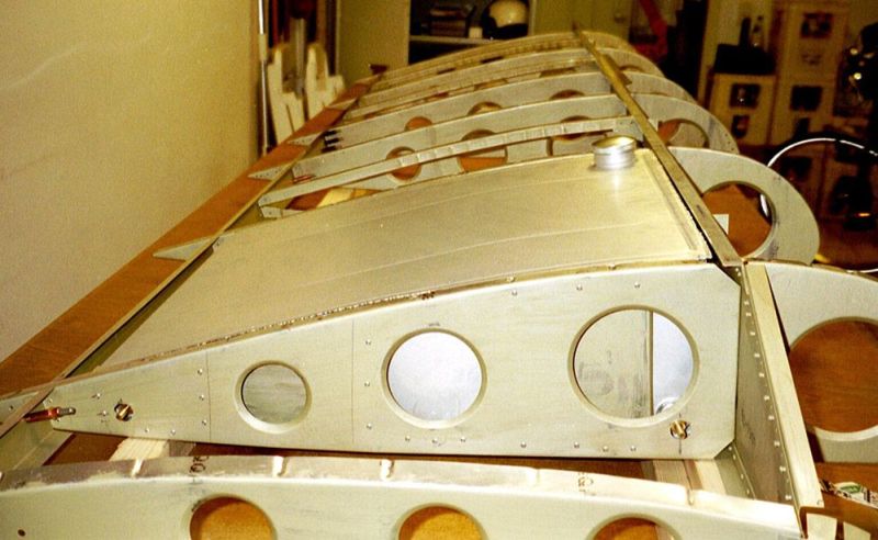

I was looking at my picks of wing stiffeners and realized that I had this pic, it sounds like what your describing for a 42.5 L or 11.2gal tank?

PostPosted: Fri Jan 09, 2009 12:21 pm    Post subject: Re: 701 Wing Tank Question Reply with quote
Yes Kevin, similar although your pic shows 2 outlets and a curved upper panel probably more capacity and advantage for fuel flow when in sustained nose down ops.

PostPosted: Sat Jan 10, 2009 9:14 am    Post subject: Re: 701 Wing Tank Question Reply with quote
Hi Kevin and Ralph,
The picture you posted Kevin is exactly what I want to build. I just can’t see wasting the area between the 10-gal Zenith tank and the rear spar. I also like the duel fuel outlets. Just like piper Pacer, Tripacers and Cubs.
