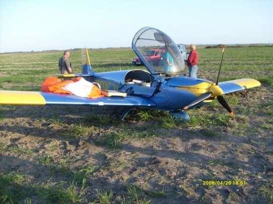

Gig
have a look here this was with a BRS in the top right front

Gig Giacona
Posts: 1416
PostPosted: Wed Jan 28, 2009 6:27 am    Post subject: Re: W&B 601XL Reply with quote
alex_001 wrote:
Gig
I've seen that Alex and the only thing I can say is that must have been a smaller BRS than the ones I've seen. When I say smaller I mean smaller than the 1350 which is the one that should be used in a 1320 lbs 601XL.
