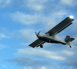

All,
Well, today was as near perfect as it gets. Winds calm, temperature about 70 (sorry about that to everyone north of Daytona Beach), sky was high thin for the most part, so I decided, after 14 years and 9 months of building time, it was time to get this bird in the air. After reading about everyone's first flight posts, I guess I was the only guy to ever be nervous flying their machine for the first time. Like everyone here knows, the ground roll was quick and short. The liftoff smooth and wow, this airplane flies great. I would like to tell you how fast I was going, but my airspeed indicator never worked (along with a few other minor things). It made for a few interesting moments, but attitude flying worked good, until the condensation on my windscreen made everything ahead invisible. Fortunately the side windows stayed clear. The windscreen cleared up after about a minute. I leveled at 1000 feet and did some turns, slow flight, and played for about 10 more minutes then headed back for a landing. It all went smooth considering I held used half flaps (11 degrees) and extra speed, just to be on the safe side. I would like to say it was a perfect landing, but it did a small 'skip' before rolling to turnoff speed. That had to be the best half hour of flying fun in a long time.
Thanks to everyone on this list for all of your help over all these years. I hope I can pay it forward some time. There are a lot of others to thank for all their help and they know who they are. However, I want to especially thank my former girlfriend, now wife, for all 14 years and 9 months of patience and support. She is the greatest!!!!
[img]cid:5F958BA9-6011-4A19-8102-7BC308447CC6(at)launchmodem.com[/img][img]cid:85E14AC6-1BF4-41F5-852A-82A636970841(at)launchmodem.com[/img]

Rick,
Congratulations and thanks for the pictures.

Congratulations Rick! A nice looking plane you've got there.

Rick
Nice fotos and congratulations on your first flight. can you give us any data on your plane?

Paul, Thanks. I don't yet know why it didn't work. I'll keep you posted on the failure analysis.
If I had known in advance it wouldn't work, I would have stayed on the ground to. As you know, by the time I got to looking at the airspeed, I was flying. I decided I would just continue since everything else was nominal. Once stabilized I used my 496 for groundspeed which I figured would be close enough to airspeed since the winds were calm.
Best regards
Gary
Gary, Thanks. Good question about the specs.
I can't provide too many real 'specs' yet, but here's a description of the plane.
It's certified as an LSA. The landing gear is the 35 pound, airfoil shaped, gun drilled Grove Gear and worth every pound. This helped drive the EW up to 853 pounds. I don't know if that's heavy or light, but that's what it is. I'm in the middle of the CG range and can't get out of CG under any legal loading.
I'll provide a picture of the panel later, but for now, it's loaded with standard 6 pack instruments (vacuum AI and electric DG) and a Sagem MFD that also has an engine monitoring system, moving map, terrain warning, data recording, etc. My compass is a Brookstone (the 'toy' store) battery operated electronic compass. It was cheap at about $50 as I recall. I velcroed it to the top of the panel, and calibrated it per the directions (very easy to do). The compass correction card is not needed because this sucker is on target at every compass point. I was concerned about it after all I read on the list about compass errors and degaussing, so this was relief. The radios are the old Terra; Comm, Nav (VOR, ILS), and transponder variety. The Nav head accepts VOR, ILS, and GPS. The airplane is set up to accept a mode S transponder, ADS-B, etc. although not installed, the antennas and wiring are in place. The audio panel is the PS Engineering 6000 with marker beacon. Whelen strobes and a home depot landing and taxi light provide plenty of recognition capability.
I also have the original Lift Reserve Indicator system with the LED/audio annunciators. There's also a G meter, electric clock, and AM/FM/CD Player (the plane is so old I would have not had this and used my Ipod instead, but...) All instruments are lit with the UMA white light rings and I have under glare shield emergency strip lights that use a 9V backup battery. The panel face is a black, carbon fiber overlay from Aero Enhancements in St. LouisThere is no key for the ignition. I use toggle/lock switches for ignition and a unique electrical signature to provide power to a start button.
The interior is standard blue fire resistant aviation carpet. The seats are NASA foam covered in sheepskin. I added a 5 point Hooker Harness restraint system and added heavy duty webbing under the seat pan.
I used to have electric trim, but 'upgraded' to manual trim because I didn't like the design of the actuator in the original design.
The airplane has 2 - 13 gallon, kreem coated tanks and the original small baggage sack. I used the poly fiber system, poly-tone paint, even on the fiberglass, and it worked out fine. With all the masking, prepping, cleaning, etc., and a very small paint booth, it took over 5 months to paint. I made every mistake possible to, but Jim and Dondie at Poly fiber were great help. I would always recommend them.
The engine is the 100 horse Rotax 912S, but uses the old style starter. The ring mount interfered with the heavy duty starter. The standard starter works fine and the engine starts easily and runs like a top. There is no noticeable engine shaking at shut down or start up. I didn't install carb heat. Each cylinder has CHT and EGT. I did use the optional oil cooler to. For those guys with the old style 15 cent coolant overflow bottle, call John at Kitfox and replace it NOW with the current $33 Rotax part (it's worth it). Mine blew a hole out the side during extended taxi testing. The engine didn't overheat, but it got really warm. Lost almost all the coolant and the smoke pouring out of the cowling was a tad scary. The new container is much more substantial. I use 100LL, because of availability and the ethanol issues. Per John McBean, I use the TCP additive he sells. The prop is a Warp Drive, 3 blade, 72 inch and is ground adjustable. I'm only getting 5200 RPM so I'll have to re-pitch it from the 17" pitch to something else. Anybody have a suggestion?
That's about all I can remember at my advanced age. Let me know what else you would like to know.

Thanks for the info on your plane Richard. I always enjoy hearing about first flights and seeing how people set up their planes.
Your plane looks and sounds great.

Rick,
Congratulations on a great first flight. That condensation on the windscreen would have given me a scare. I’ve had that happen in cars when passengers had wet clothes and outside temps were low. As to your weight, I piled everything not installed on board my Fox as close as possible to where it will be installed and weighed my Model 5 a couple of weeks ago, and my weight came out very close to yours. When I read yours, I looked on my desk to check mine, but my weight and balance calculation is apparently at the hangar. In any case my memory tells me we are probably within ten pounds.
It sounds like you took everything in stride and pulled it off wonderfully. Great going.
