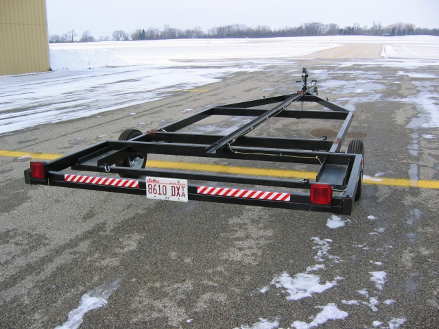

n85ae
Joined: 14 Mar 2007 Posts: 403
Posted: Fri Jan 09, 2009 1:37 pm Post subject: Re: Trailering a Kitfox |
By the way, here's one of the trailers I made. The center rail is
designed to elevate at the front to adjust aircraft attitude on the trailer.
And there is a swing open bar at the back,

Jeff is correct.
It is true that the area under the G vs time curve is significant.
And it is true that several short duration spikes have little
significance to a space frame structure like our planes. When
trailering it is logical that more than several spikes would be
present and definitely cause harm due to the normal fatigue life of
the metal and welds.
Trailering is a high risk activity and should be minimized. Ie short
trips at low speeds.
Anyway don't miss the point of my post which says make sure you have
a soft riding trailer.
Wings off will eliminate the spar/pass thru problems and certainly
minimize the fuge loads. A soft play ball under the rear of the fuge
would be a good addition to any setup so as to keep any vibration
loads from the tail wheel attach and the unsupported fuge.
Soft tires would be a good help.
Paul

Actually something to consider is your tiedowns. If you make your tires
really spongy, etc. Odds are good your planes gonna get damaged by
banging against the tiedowns. It's better to tie it down as tight as possible,
and let the trailer suspension absorb the shock. The plane should be tight
and the trailer suspension soft. That's the best way to do it.

Of course the amount of time a force is applied makes a difference - but
only as regards the mass and inertia of the object being acted upon. We're
talking about fairly massive structures here (the wings) and they of course
will not respond to millisecond forces. We're talking about bumps in the
road and gusts of wind as the damaging forces. But don't forget also we are
talking about forces on a pivot point where the forces are acting along a
moment of the length of the wing. I assume you know how to do a
weight&balance using moments?
Now fly an airplane where the critical support structures that hold the
wings on have been weakened by metal fatigue from repeated forces too small
to break the structure, you do know what metal fatigue is? The wings *will*
fall off at a much lower G stress than their rating if not damaged. You
*will* fall out of the sky due to accumulated "momentary spikes" that you
said "mean nothing".
The solution, as I see it, thanks to posters on this list, is to eliminate
the moment multiplier of the force by not allowing the strut connect points
to be pivot points = support the wings.
