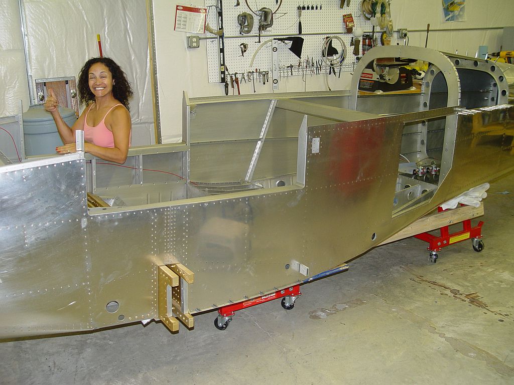

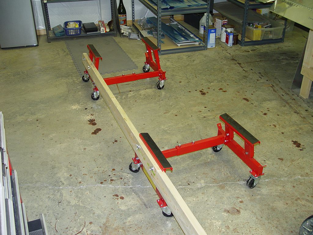

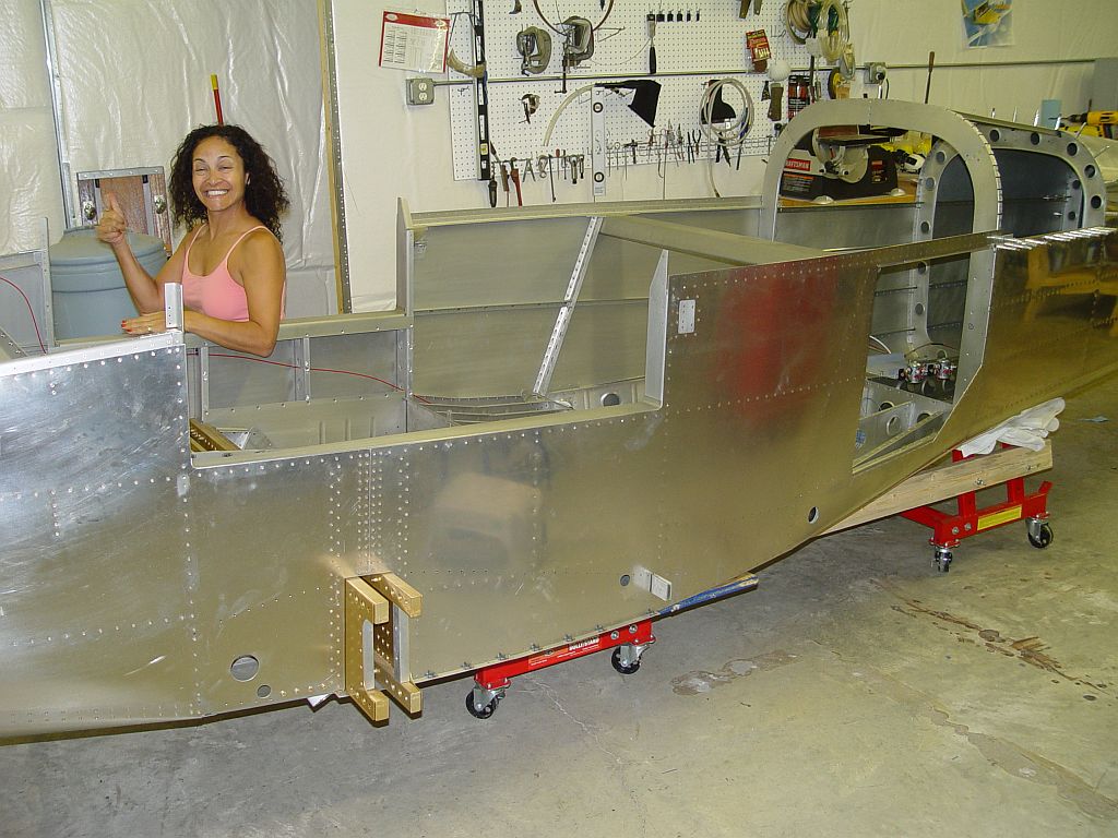

I used two motorcycle stands from Harbor F (they were on sale). I used a couple of 2x4s to connect them, then I threw a 4x4 board on top. Crude but it is VERY easy to roll around.

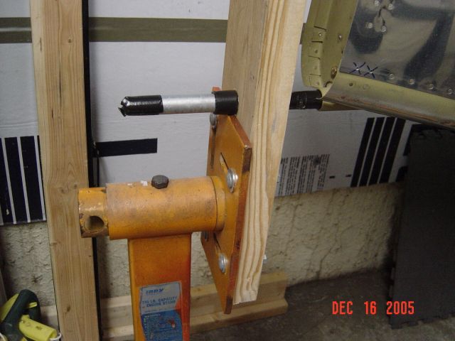

n8zg(at)mchsi.com Guest
Posted: Mon Jan 12, 2009 7:29 pm Post subject: Fuse Stands |
Phil –

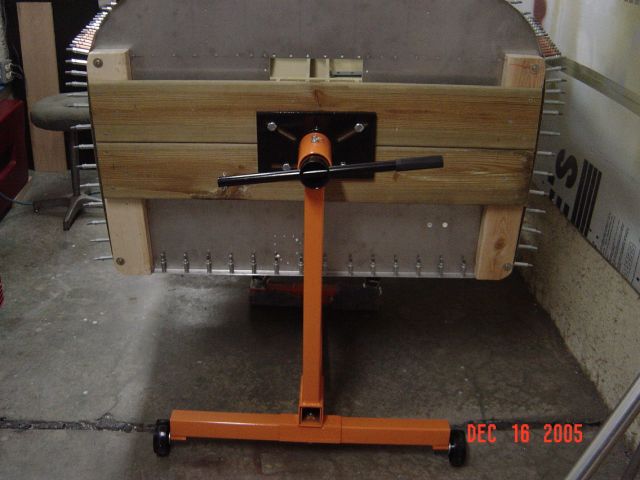

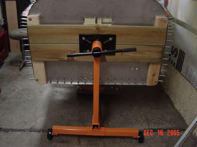

I used two engine stands from Harbor-Freight on my RV-7. Minor changes to the aft attachment would adapt it to the -10.
Does anyone else have photos of similar fuse holders?
Phil

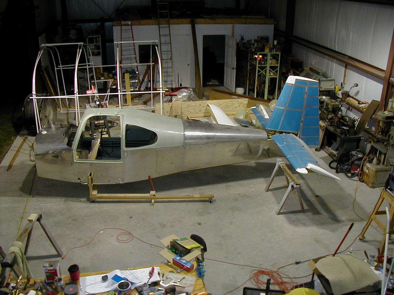

Here's the best pic I have of my fuse stand. all 2X4s .... the uprights
have a screw (protect the spar with plastic hose around the screw)
through the wing attach holes, and the blocks on the step keep it from
sliding off. One crosspiece across by the uprights. Then I added an 8'
2X4 under that because the CG went too far aft with the tail feathers
on. Note the block on the floor next to the step ..... the 8' 2X4 sags
too much and needs another caster. This keeps the fuse low so you can
lean over to work on the innards and it rolls around when I need it to.
Linn
