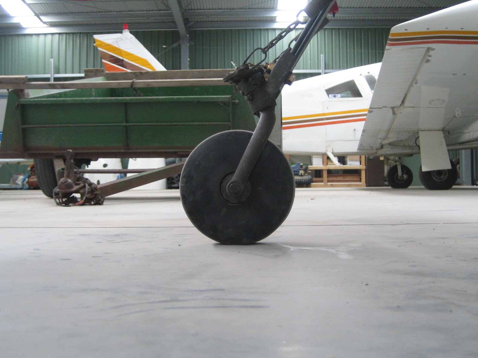

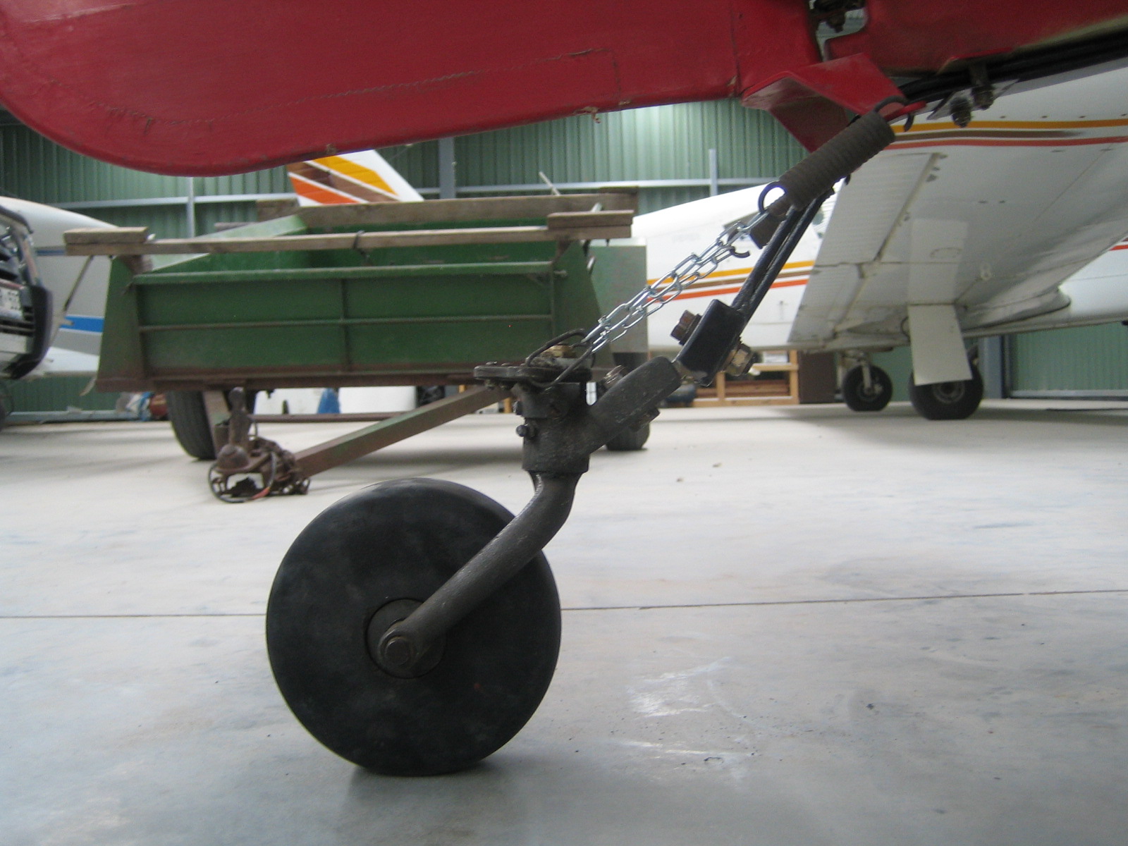

I guess I was being petty and "spat the dummy" for those of you that are not interested please press Delete "now".
I fitted the adaptor this morning and it brought the King Pin vertical (see before and after Fotos).
Taxi tests and some circuits proved that all is good. No shimmy at any taxi speed, good stable, longitudinal control yet not heavy on the pedals.
All that is required to unlatch the tailwheel now is a tap on the brakes and/or full rudder deflection.

Well I was going to post the fotos of my new setup plus results but certainly don't want to offend Frank Miles or others - I'll send the details off-line!
Gary

Gary - so you're saying the 0002 picture with the vertical angle worked better for you? You're leaning me away from the "Matteson Geometry" now (sorry Lynn), towards what I would have originally thought more logical.
And I think I might worry a bit about those "plant hanger" chains in 0002 that it looks like you got from Home Despot? The only reason I mention the chains is that it looks like ones I bought for a tractor "job" and regretted (ie VERY weak) and replaced with stronger ones from Tractor Supply.

Yep Bob - for me it addressed all of my problems.
I won't be leaving the plant hanger chains on there. I am trying to find a supplier here in Oz that sells the right chain but it isn't as easy as it was in the US and Canada.
Gary

No problem, Bob. The so-called "Matteson Geometry" is merely bolting
a Maule tailwheel ass'y. to the 3-leaf McBean spring. I did nothing
to add or detract from basic parts. It just works....for MY plane.

You can also try a marina or truck supply... sometimes the lifters on roll doors have chains. Just thinking out print... (loud doesn’t suit here) pet suppliers may have the chain you are looking of to make runs for dogs.

For what it's worth, I copied Gary's JPG to my cad program and measured the
angle and it is 2.9° on the Matteson side of vertical. This done after
leveling the image in Photoshop with the joint on the concrete floor.
I had previously measured the original photo he posted the same way and it
measured 13.5°.
I think this can relate to other aspects of flying, Angle of attack is good,
just don't take it too far. The fifteen to twenty degrees in the
aftermarket article? Not good advice. Gary with less than that found it
unmanageable.
Lowell

I just did the same thing Lowell...set the joint level by rotating
the picture 1.5° degrees clockwise, and it looks to me like the top
of the kingpin points to the front of the plane, not toward the rear
like mine does. I dropped a line from the center of the kingpin nut
(as close to center as I could), and it looks like the kingpin top
points forward, doesn't it?

Hold the presses.....we are BOTH assuming that the plane was rolled
into the building with the centerline of the plane parallel to the
joint in the floor, which it may not be. Imagine if the joint was at
a 45° angle in the picture, and we level the joint.....now we've got
one wild a-- angle on the tailwheel assembly. I think we better take
Gary's word for the new angle, if he can measure it.

100lb. test should be strong enough. Strain on the chains is limited by the springs and the steering lock release. But like all things aircraft, keep a critical eye on it. When I was in school one of my instructors said no inspection was complete without finding at least one fault.... My problem is I tend to find several... not all require immediate action though or I’d never get into the air.
