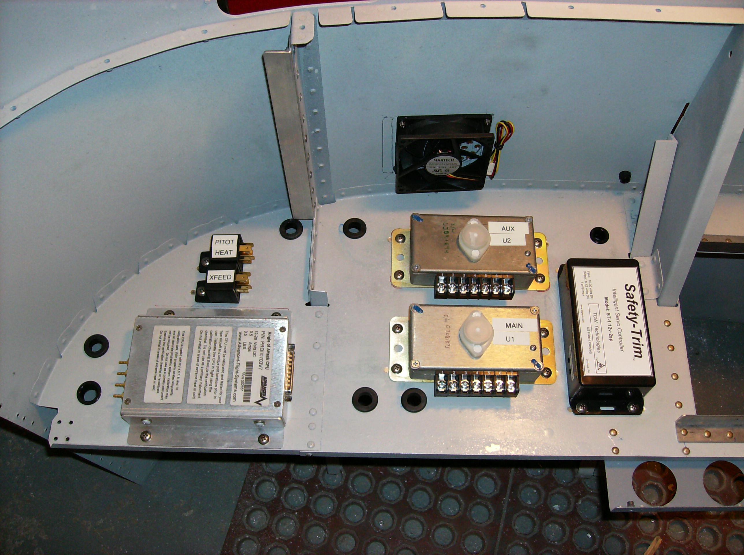

Posted: Tue Jan 20, 2009 8:21 am Post subject: Re: AOA CPU |
Subpanel photo attached... The AOA CPU is in the lower left hand corner. The AL angles used were 1"x1" (trimmed one side) as the AOA screw holes didn't line up to be able to use 3/4 x 3/4 angle without cutting yet another subpanel hole.
Jay
