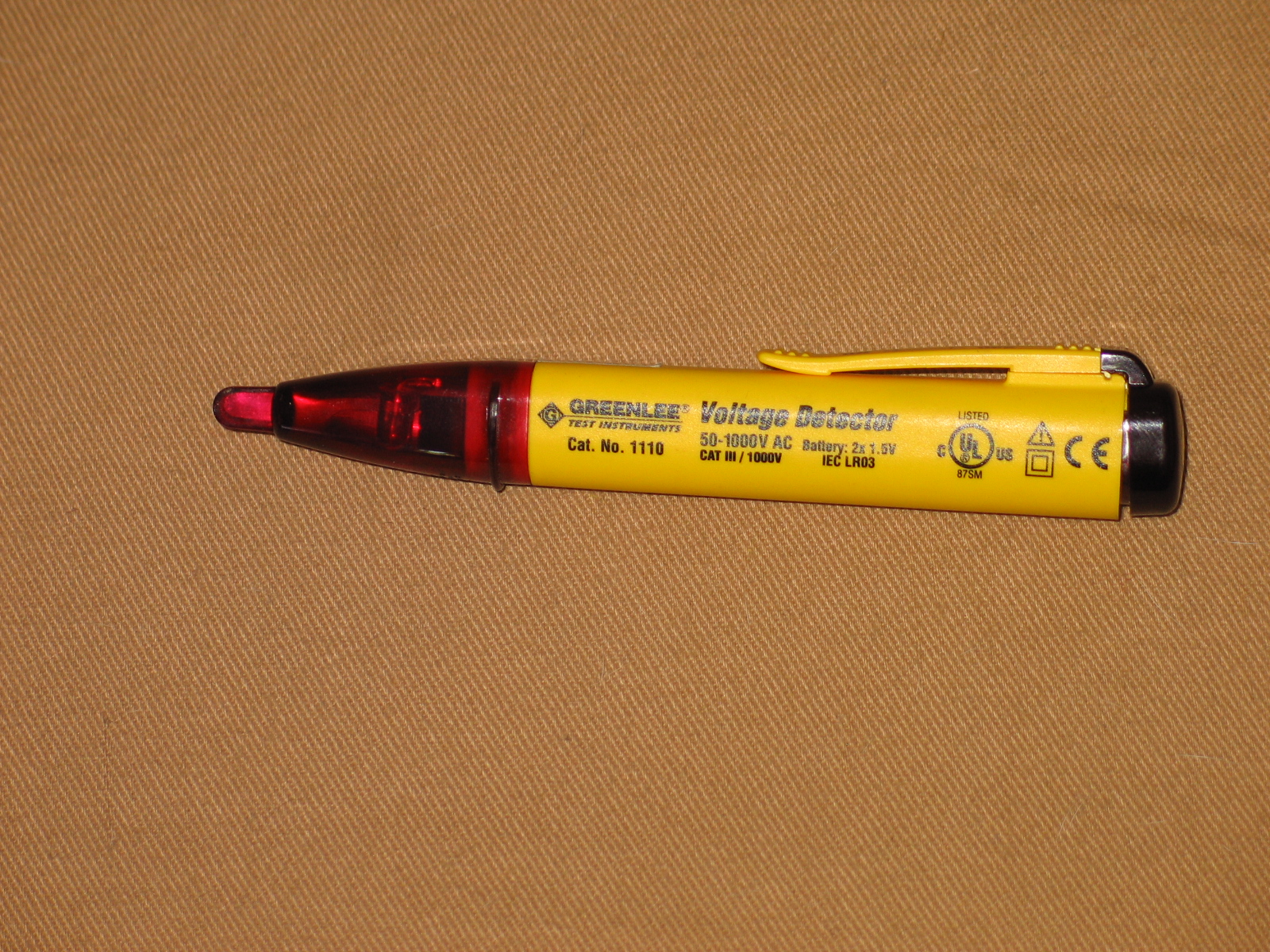

Just buy an AC power tester like the one pictured. It's about $12. Hold it up next to the wire and it will flash with regular flashes if you have a good wire and plug. If the wire is bad it won't flash or only once in a while.. It only has to be next to the wire it doesn't have to touch it. You can diagnose an entire wiring system in no time or find where a break in the plug wire is.

That is why I like using my tester. You do not disconnect anything. Just run the engine as normal and hold the tester by the wire. You can even move it along the length of wire and it will detect a break.
Just another diagnostic tool to toss in your bag.

Roger C OK C I am sold. I Googled up the Greenlee tester. Yours (thanks for the picture) is 50-1000 volts. Greenlee has 2 models C yours and a low voltage model for 12-90 volts. I would guess I want the low 12-90 volt model for our application. But C as I stated C yours is the high voltage model. Does it work on 12 volt ignition systems? They are less than $15 apiece. I guess the question is academic C might as well buy both at that price.

Hi Pat,
The tester you want is the 50-1000 volt. Spark plugs are high energy AC. Then when you aren't using it on the plane I'm sure you have some honey do's where it might come in handy. It will not work on 12 volt.
The modules don't go bad that often. They are over a $1,000 each. If you are only dropping approximately 300 rpm then it is a plug or wire. It is not the module. A bad module is about 800+ rpm. The plug wires can be replaced as they are only screwed into the plug boot and ignition coil. The tester I posted will pick out the bad wire or plug. Most of the time it is a bad connection at the plug boot or a bad ground wire up by the modules. Find the effected wire with the tester. Pull the plug boot and trim the wire back about 1/4"-3/8" and re-insert the wire into the boot and or change the plug. You can unplug the modules on top of the engine and swap them and see if the problem follows the module during a mag check or stays the same. This will help tell you, along with the plug wire testing where to start looking.
Who ever is having the problem what is the rpm drop during the mag check? Depending on the rpm that you do a mag check at, the rpm drop will be between 60-100 rpm. You should not do a low rpm mag check because it is hard to see anything. 3200-3500 is where most do their checks. At about 3300-3400 rpm the drop is about 80 rpm. The higher the rpm, the higher and easier it is to see a good mag drop or feel engine roughness. Doing a mag check at too low an rpm is not helpful.
