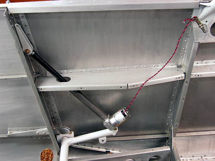

Matt, I simply bent a piece of scrap Al (025 or 032??) to mount my POS-12. Since the screws fastening the support to the bulkhead were inside of the baggage wall (between the baggage wall and the fuselage skin), I used #6 nut plates (for future service). In addition the termination of the wires (pins and barrels) are on the fwd side of the bulkhead (in case I needed to change out the sensor in the future... old photo during construction). You'll need to adjust the length/position of the threaded rod/clevis for the appropriate travel
Pretty simple and has worked well on my AF2500.

Forgot the photo, sorry.
