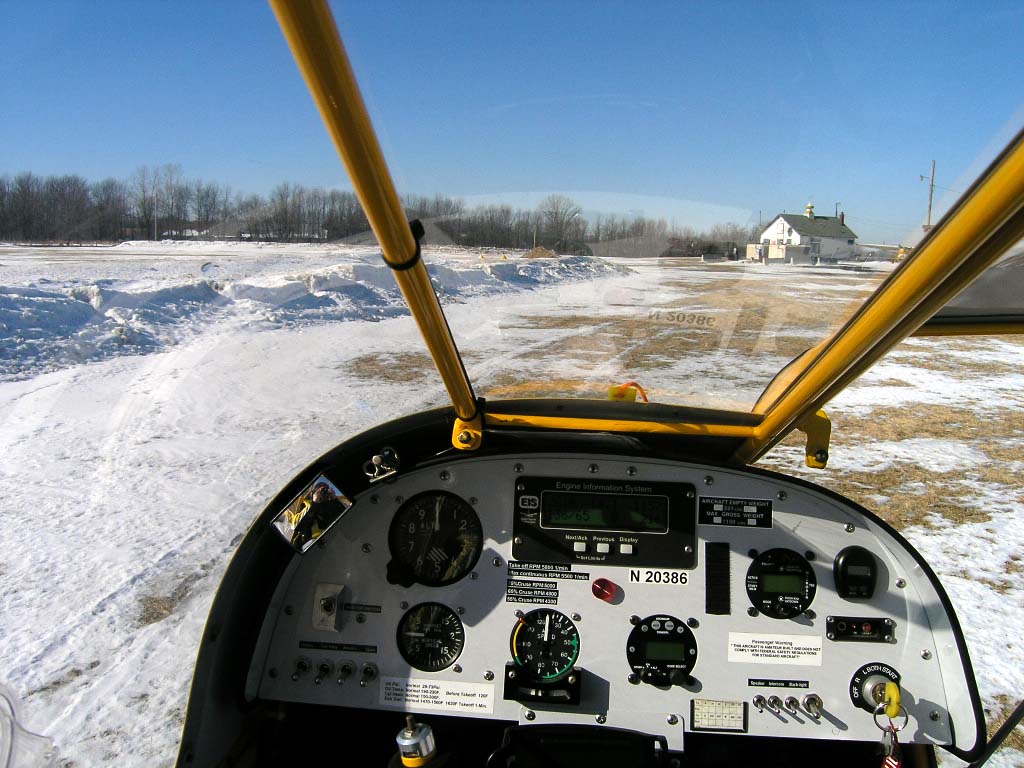

I took a 2-hour flight today in the Kolbra as it got up to 39 degrees in the afternoon. Here are a few pics.
